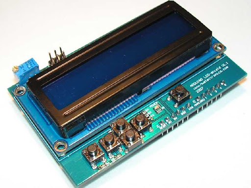

Setup ends with displaying the first album on the LCD screen. I use a Nuelectronics LCD screen with buttons like this:
Use up and down buttons to display the next or previous album on the LCD screen (see next()). Pushing key 0 sends an AHK command to the pc, adds the title of the selected album and starts the first song in iTunes (see start()).

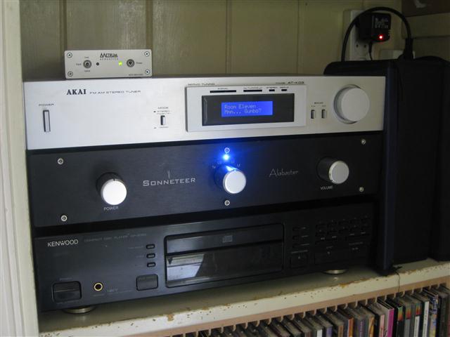

All works fine on my laptop for now:
Next is to set up a second hand pc as iTunes server with digital out (toslink or coax). This I will connect through a dac to my stereo. I'd like to convert an old AKAI digital tuner into the music server by exchanging the screen with the Arduino LCD screen. But this will take some time.
The code works well and certainly fast enough. Improvements and suggestions on how to use a NAS instead of a pc are welcome.
