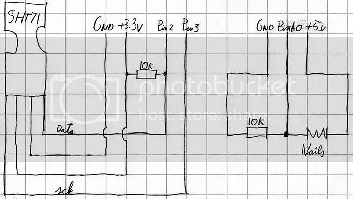

Measuring temperature and humidity is simple with an SHT71 sensor

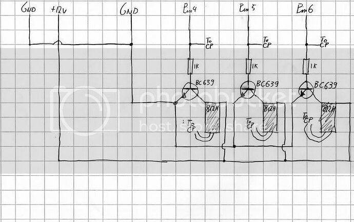

Controlling with a few relays
I'll be pulling log data over the serial connection and using Gobetwino to store them in as a .csv file
I had most schematics in my head but I drew them up for you guys.
Here are the two sensors, and yes the nail trick I "borrowed" from the Garduino instructable.

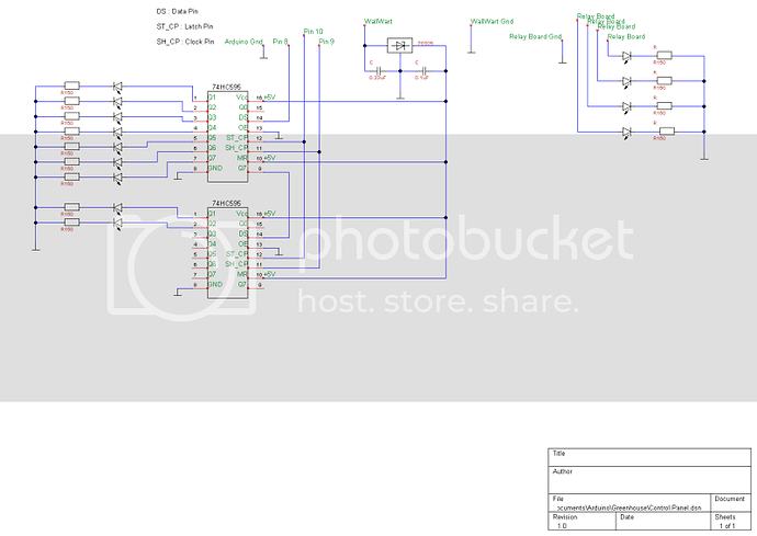

Here is the control panel which shows power, status of temperature, humidity and soil moistness. Whether lights, fan or pump are on and mains switches for lights, fan and pump.
And the relay board, and yes I have forgotten about the diodes in this drawing.

Hi SpencerH,
Do you really have 3 phase power or are the three "mains" wired the same active.
6A @ 240V means huge motors, are they really that big?
I gather they are DPDT relays and the "to CP" contacts are just to show they are working with the other pole doing the pump/whatever control.
Rob
Hey,
It is just two phase mains. And chose the 6A fuse as the max current for the relay is 7A. But I can always swap the fuse for a smaller one as the lights will probably draw a maximum of 1A. And the switches on the control panel are just a sort of kill switch just in case something like the water pump freaks out.

Just to be sure I double checked the current tolerances on all the parts of the relay board, I just got a lamp and it draws 2.2A at 250V so that should easily work.
And I swapped the transistors on the relay board for optocouplers as I had a pile of them lying around the house. I checked the current limits and I have about 20mA overhead.

Control Panel:
Relay board:
