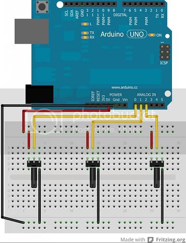

Any way I wanted to share the working sketches and the Arduino layout in case anyone else wanted to give it a shot. As always, advice is welcome and if you do this please share your experience. :slight_smile:
Arduino Layout:
Arduino Code:
