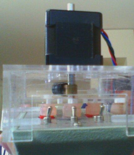

I needed a way to get an astro CCD camera sequenced with a stepper motor driven mechanism, which controls an equatorial mount hand controller, sequentially repositioning the RA and DEC axii between exposures to dither the images. A box shaped spiral was the best pattern for my purposes.
The stepper mecnanism was originally sequenced with a DSLR on the same mount. The CCD camera replaces the DSLR and is still under warranty, so soldering wires here and there is not an option. The mount is quite old, manual, but very accurate.
On the camera side, I used a Freetronics TEMT6000 light sensor break out board, connected to an analog pin to read the camera operation LED, which indicates whether the camera is exposing or not (doing other things).
On the mount side, I use a bipolar stepper, driven by an L293NE, on a home made arduino shield, to push the hand controller buttons between exposures.
The LED is either off, on or flashing. To differentiate flashing from on and off, I tied a capacitor between the sensor output and GND, which restricted the minimum and maximum values, sampling a mid range.
The code might be helpful to understand the concept fuller - though I warn you, it is very amateurish.

Sorry i can't help much on this but i've heard of people using linear ccd's from old scanners, as everything in the sky is moving anyway theres no need to move the camera, just take slices at the right time and software puts them back together, just like a scanner
I've read a little on the use of linear CCDs - an interesting concept. I imagine that the old GEM CCD/DSLR imaging paradigm may come to an end eventually because of improving technologies such as linear CCDs.
I guess I'm working with what I have to get the best image results, without hacking into devices. I tend to look for non intrusive solutions to avoid damaging expensive components and the expense of upgrading equipment.
I've since changed the code, removing the capacitor, adding the Arduino smoothing script to average on/off indications. The capacitor was too erratic and unreliable, with outliers triggering the dither mechanism during image capture.
