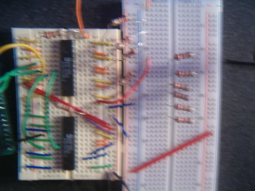

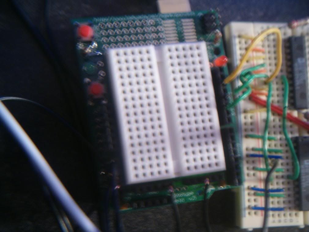

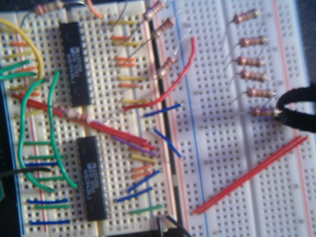

I've designed my own board for the second version of this. It has LED drivers on-board instead of the potentiometer, which allows the LEDs to be much brighter and have a wider range of colours. It'll still be driven by the Arduino, at least for now. I'm hoping to find a few like-minded tinkerers in order to split the costs of ordering boards. I've posted more details here. I'd confirm that the board works electrically first, and then send copies out to a group of people who can all play around with it, sharing Arduino code and interfacing software.
If you're interested, please send me a message (an email to the address on that page, or a PM on this board) and I'll be in touch.
square, i am a little confused on how to get the first revision working.
ok, for the buttons, i connect the button grounds straight to the arduino, while connecting the power pins through pull down resistors? or the other way around? And laos, how do i check for button presses that way through the code?
and as for the led's;
why are they all the transistors connected to the analog pins? what is supposed to be sensed?
And finally;
how do i hook up the second digital potentiometer ic? it was VERY briefly explained, but it would be easier for me to receive a pin from the digital pot, to connect to the arduino. The other pins i got, just that one single pin that is different then the first digital pot.
thanks in advance!
good luck with the kit!
The button grounds go straight to the Arduino (to input pins), with a pull-down resistor. The button power pins are connected to output pins, which you bring high one at a time in sequence. You check for button presses by reading the input pins. You know which row is being brought high, and you read input off of four columns, so you know all the button presses. The sequence is: set all rows low, bring row 1 high, read all four columns; set all rows low, bring row 2 high, read all four columns; etc.
The analog pins are being used as digital pins here. You can address them like any other digital pin, numbers 14-19. The transistors are there so that the Arduino pins don't need to source too much current.
And finally;
I'm not sure I understand the question, but you connect all of the digital pot pins on the second pot to the exact same wires as the first one, except for the slave select pin. Then you send data to one pot by setting the slave select high on one and low on the other, and vice versa to send data to the other pot. If you get the AD5204 instead of the AD5206 there's a serial out and you can daisy chain the chips, but the 5204 is only a quad potentiometer, so you'd need 3 chips instead of 2.
I hope that helps!
ok, this cleared alot up, but i have a few more questions;
resistor values seem to be different all over the board, what values did you use for the led's to light up, and what values did you use for the pull down resistors?
Now the digital potentiometers make more sense, but what pin did you connect the second slave pin?
and if i understand, your explination means that both digital pots cant be on at the same time?
So they are switch to and from very quickly im guessing.
And the code posted up top, Is it the code for the first video on the page? where the one color gets sent to all the other colors when pressed?
Also, how do i work with the code, meaning how do i make random colors appear? and how do i change individual buttons colors? The code is interesting, but very confusing, which means you did a good job shortening it! If i cant read the code, it means it's good, so don't worry, im just noobish at c... but i'm learning.
Thanks alot for the help already, and i cant wait to get this up and running hopefully tomorrow when my rgb led's get here. Stupid mail took almost 2 weeks to get them here...
Good luck with the future of this project!
-big93
hmmm, i'm also having trouble hooking up the pull down resistors, can you tell me how you hooked them up?
i connected the brown black orange resistors together, and grounded them, and i connected the red red brown resistors to arduino pins, and i connected both of the other ends together, and connected the switch pins to with the resistors:
so it was like this
Wire to arduino -----> connected to red red brown resistor-----> connected to both button ground, and the brown black orange resistor -----> connected to ground.
with the sketch above, it seems only 1 row of buttons lights up, and the last 2 rows of buttons light up when i press the buttons, and the row in between them doesent do anything...
thanks in advance

im still trying to set up your first version of the project, and i cant get it working, if you could look at the posts on the last page and help me figure out whats not good, i'd be very gratful :slight_smile:
it's just that i have this huge buttons pad sitting on my desk, and it doesent seem to be working, and wires are running everywhere, and there bread boards to the waazoo, as soon as i get this running i can stick it in a nice case, and furthur program from there.
the code you gave me is so far just making rows of the same color light up except for one row which isint lighting up, and 2 rows of which only work when i press a button, and the last row, is on, but when i disconnect the button ground, then the buttons freak out for bout a second, then they all turn on... wierd, if you could put up a schematic just for how you hooked up the buttons, i think i could get this working.
thnks
