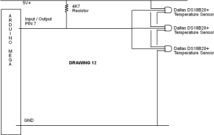

First of all, I'm not sure I understand how to wire the sensor correctly. I'm trying to use the powered mode, because I can't for the life of me figure out how the parasite mode is supposed to be wired. But if I'm doing powered mode, is this right?
sensor pin 3: 5v, through 4.7K resistor (the other end of which goes between pin 2 and the data wire out to arduino? This part makes no sense to me)
sensor pin 2: the other end of the 4.7k resistor, then to the data wire
sensor pin 3: Ground
Thanks for your help,
-mike
Hi Mike
Here's what you need :
pin 1 goes to Ground
pin 2 goes to input pin and to 4k7. Other side of 4k7 goes to 5v
pin 3 goes to 5v
(edited to show correct pins)
see attached drawing.
Next, you need to get the sensors unique address.
To do this, upload and run the following, which will detect the address and display it in the Serial Monitor :

I had the pin numbers incorrect and have already edited the previous post.
pin 3 goes to 5v
You will also need to download the libraries from the URL included in the sample code.
Also, as you see from the diagram, you can have multiple sensors all on the same input pin.
For each sensor, you need to run the first sample code to get each sensors unique address (with only 1 sensor connected), and add it to the second sample code so your code knows which data coming into the input pin is for which sensor.
Thanks a million, DaveO! Everything worked like a charm, though I did have to tweak one small thing to get the code to work to detect the sensor address.
Where you put:
if (addr < 16) {
and:
Serial.print(addr, HEX);
I think in both cases it needs to be addr
But I'm all set, recording temperatures all over the place (well, not all over the place - actually very consistantly. If they were all over the place that would be a different kind of error :wink: ). Thanks again!
