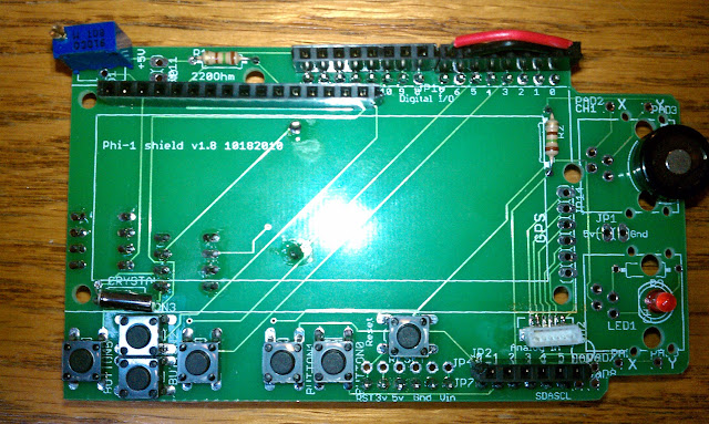

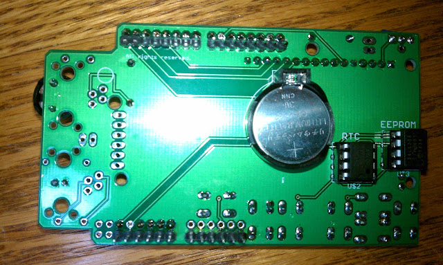

Introducing Phi-1 shield LCD/button/GPS/EEPROM/RTC
I've designed a shield for beginners to learn and prototype with character LCDs, buttons, real time clock, EEPROM, and GPS.
The shield makes it very easy to use the above parts so a user can concentrate on his/her project ideas instead of which wire is connected wrong.
The shield is compatible with arduino UNO, MEGA, and Duemilanove. It also has spots for two RJ11 jacks so you can extend your arduino's reach as far as a phone cord can take you, without messing with wireless or jumper wires or screw headers.
Details and sample codes are posted on http://liudr.wordpress.com
Here is a couple of pictures:

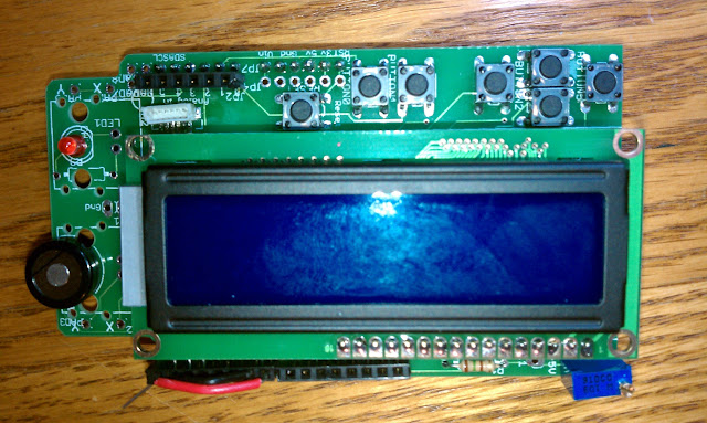

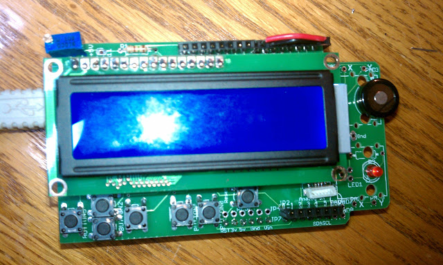

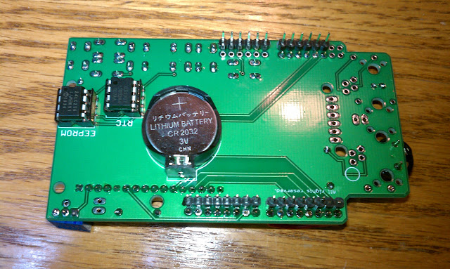

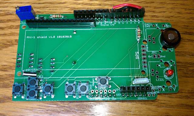

Here are some pics - let me know if you want to see something specific.:
The code that I am using is the testing code from your website (Phi_1_testing_v1). I also tried the Phi_1_test_clock_v1.
Everything looks good on the picture. Now, if you can pull the LCD out, test the pins 7-14 to make sure they're all isolated from one another. The red jumper could use a little push down on the left side.
