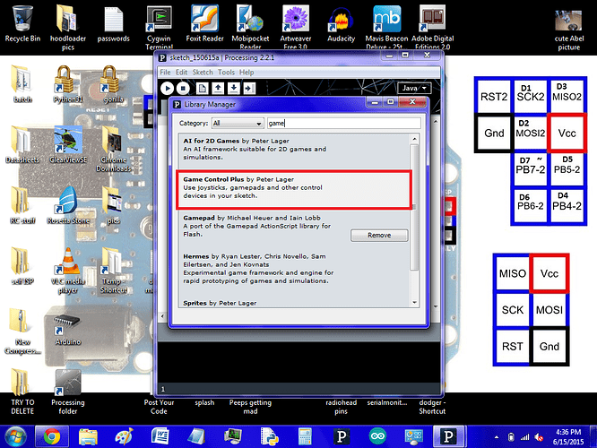

I made a RC system-to-joystick interface with UnoJoy! It uses the PinChangeInt library to read the signals and maps them to HID values. Then, they are sent to the computer. I use it for the (free) ClearViewRC simulator and a game written in Processing by Paul Lager, Gcp_Tanker. It is an example for his Game Control Plus library, which can be installed by:
  • Open Sketch>Import Library>Add Library (menu.png).
  • Then search "game" in Library Manager (library manager.png).
  • Click "Install" on Game Control Plus and look at the examples for it.
Open Gcp_Tanker and configure your controller.
Click Use and play away! (Tanker.png)
