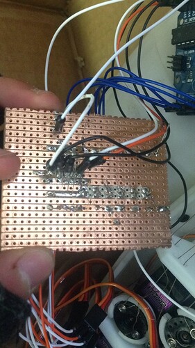

I do not have any CAD drawings, they will be completed in a few weeks (we were told to draw the circuit first).
Here is the veroboard which is connected to the arduino, the wired connection on the underside are for the A0-A4 pins for each flex sensor. The Servos are connected to the '~' connections of the arduino (being connection ~3, ~5, ~6, ~9, ~10) .
Not a capacitor in sight!
Grumpy_Mike:
I had actually just placed a 470uf capacitor between the leading ground and 5v leads right after posting; thought it may be a good idea.
Still having jitter every so often, and the same problems are occurring. Sorry for not updating the progress.
Is it less often that without the capacitor?
Also try a 0.1uF ceramic in parallel.
