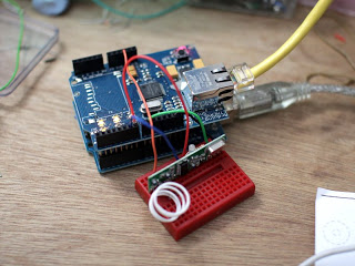

Hi, I wanted to progress my learning so I created a tweeting fridge shelf, which tweets the amount of milk in a fridge using VirtualWire & Twitter librarys, an Ethernet shield, a FSR and a RF pair. This code could be applied to any analog input. I used a FSR in this instance to measure the force so its not that accurate but does the job.
This is my first Ardunio project which combines several tutorials (all referenced in code). I'm aware my coding isn't great and could probably be refined any assistance on tidying it up would be welcomed.
Transmitter
TWITTER RF TRANSMITTER CODE
Transmit an analog value via RF.
Hardware:
Arduino Mini Pro 328 3.3v
FTDI Basic Breakout - 3.3V
NCP1400-3.3V Step-Up Breakout
RLP 434-A RF transmitter module
Square Force Sensitive Resistor (FSR)
2xAA Batterys
Microswitch
Note:
code probably needs some tidying up
make sure your antenna is the correct length (17cm for 434mHz)

Receiver
TWITTER RF RECEIVER CODE
Tweet a text string when a value is received via RF.
Hardware:
Arduino 328 Duemilanove
Ethernet sheild
RLP 434-A RF recevier module
blue/red LED
Note:

nice job :slight_smile:
