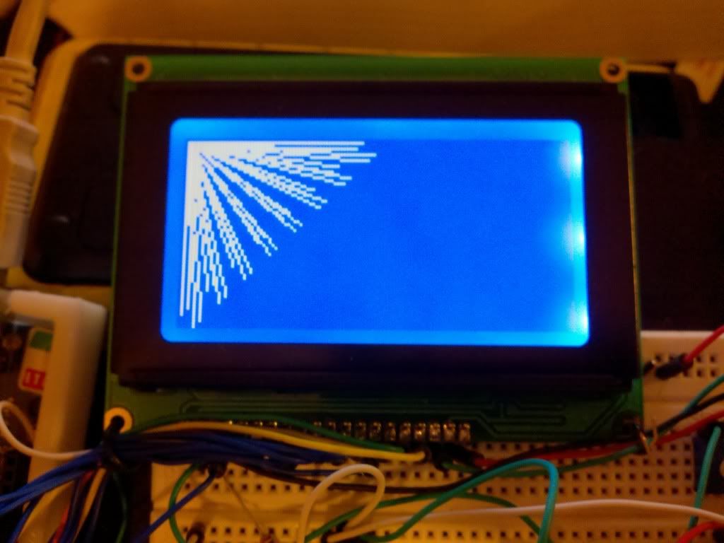

As for the second quote.. yea, its a little hard to explain without a picture. I need to setup a photobucket or something to be able to upload pics from, but in any event it came out distorted like when you draw something on an LCD over top of another output on the LCD.

Ok, so I'm including a picture of what I was talking about in the first post.. this is GLCD.DrawCircle(0,64,64, BLACK);

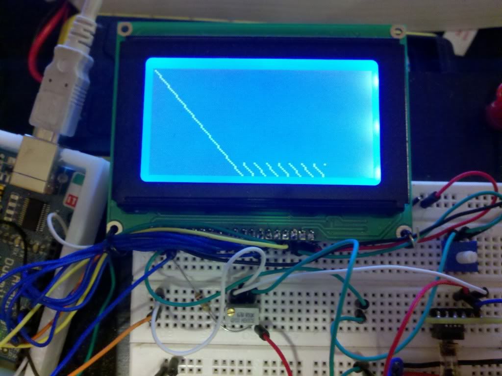

So.. good points: I understand alot more about the equation of a circle and Bresenham's algorithm.. I was able to derive an equation for a quarter of a circle: Y = sqrt(radius-sqrt(X)^4) Draws an awesome curve on the good ol' TI-83.
Now for the bad.. I still feel like a retard.. I can't even get a squiggle let alone a curve.
I could not get this code to work.. It might just be me.. I'm not terribly experienced at coding.
int x = 0;
int y = 0;
int cx = 100;
int cy = 100;
int rx = 20;
int ry = 20;
for (int i = 0; i < 2 * PI; i += .01) {
x = cx + sin(i) * rx;
y = cy + cos(i) * ry;
GLCD.DrawLine(1,1,x,y,BLACK);
So yeah, as you have probably guessed by now I am completely lost.. If anyone has any insight or can point me in the right direction please point directly towards the screen and think of me.. Thanks guys!
The lines in the last photo in reply #6 are because you're drawing the radius, not plotting points on the circumference.
Forget sine and cosine (you'll either underplot or overplot at some point unless you vary your angular increment).
Forget pi - you're not interested in the area or the length of the circumference.
