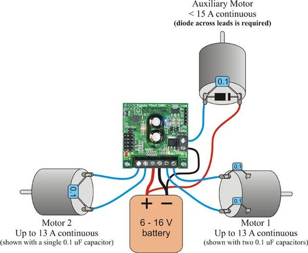

24  Using Arduino / Project Guidance / Re: airsoft gun motor causing servos to twitch on: March 06, 2013, 10:42:42 pm
DC motors have commutators in them, and when the brushs pass over them, they sometimes hit a gap. This gap cause the motor to loose power for less than a hundredth of a second (depending on speed) and will cause fluctuations in the current. These capacitors help reduce the fluctuations by temporarily acting as a load, and keep the current consistent. Motor diagrams 1 and 2 are both good to use, but I sometimes combine the two diagrams, if needed.
THANK YOU. That's the most competent answer I've seen yet.
25  Using Arduino / Project Guidance / Re: airsoft gun motor causing servos to twitch on: March 06, 2013, 06:39:58 pm
From Wikipedia:
Quote
Another kind of decoupling is stopping a portion of a circuit from being affected by switching that happens in another portion. Switching in subcircuit A may cause fluctuations in the power supply or other electrical lines, but you do not want subcircuit B, which has nothing to do with that switching, to be affected. A decoupling capacitor can decouple subcircuits A and B so that B doesn't see any effects of the switching.
This describes the problem in general but doesn't give an example of specifically where the best place to put them would be. You can put one near the gun, on the servo power lead for each servo, on the power lead for for servo controller, at the relay that switched the gun on, at the power supply for the gun, etc. See the problem? I need someone who understands this stuff to say, "oh, the best place to put the caps would be at _______".
Then there's also the idea Nakarus was talking about:
Quote
make yourself a metal sleeve that fits around the area with the motor, and then tie that into ground.
is it best to place it around the gun motor or around the servo motor instead? is this supposed to function like some sort of half-*** faraday cage?
See the 3 different options for caps and diodes that are applied to the motors in the image below?:
Aren't they there to prevent the same problem I'm experiencing? Which configuration would be most effective?
26  Using Arduino / Project Guidance / Re: airsoft gun motor causing servos to twitch on: March 06, 2013, 12:17:40 pm
The new gun is similarly sized and has a similar weight. If I wanted to use a heavier, larger full metal airsoft gun I would've bought their "Heavy Turret" product instead. The new airsoft gun is just better quality (not that there was anything wrong with the original gun). The new gun is still plastic though. So what do I specifically do to shield it?
27  Using Arduino / Project Guidance / Re: airsoft gun motor causing servos to twitch on: March 06, 2013, 12:00:10 pm
not really. The new airsoft gun has a bigger motor. The solution is simple I would think. We just need the right expert to stumble upon this post. Then he would say, "oh, you need to completely shield the motor by placing blah blah blah in such-n-such way" or "oh, you need to ad caps of this type in this specific configuration". See, that's what I'm hoping for. An actual experienced expert on the topic.
28  Using Arduino / Project Guidance / airsoft gun motor causing servos to twitch on: March 06, 2013, 11:01:25 am
I bought this autonomous airsoft sentry gun from realsentrygun.com http://www.realsentrygun.com/Paintball%20Airsoft%20Turret%20Kit.htm . It works great but I wanted to put a different airsoft gun on it. When I put my own airsoft gun on it and wire it up, the left/right direction servo has like a big twitch when the airsoft gun fires. It didn't do this with the original airsoft gun though. They built it with 'ceramic disk capacitors' going along the wires that power the airsoft gun's motor. When I put my airsoft gun on it, I didn't use them because I didn't understand why I needed to. I've also noticed that the further the airsoft gun's motor is from the servo, the less the servo twitches when the airsoft gun fires. Can anyone explain WHY I need those capacitors, SPECIFICALLY what they do to prevent the interference caused by the airsoft gun's motor, and what I can do to get rid of the interference problem completely?
