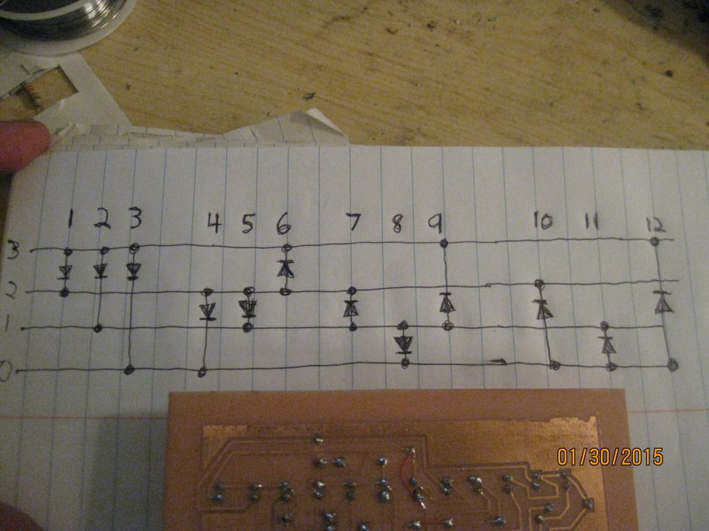

I built this:
The pins at the bottom are numbered in the order they connect to the 85. I'm just trying to get something working with 12 leds for now.
I found some code that compiled and loaded fine but damned if I can get it to work properly...
the matrix is like this (led ground is the first number):
Led1-2,3
Led2-1,3
Led3-0,3
Led4-0,2
Led5-1,2
Led6-3,2
Led7-2,1
Led8-0,1
Led9-3,1
Led10-2,1
Led11-1,0
Led12-3,0

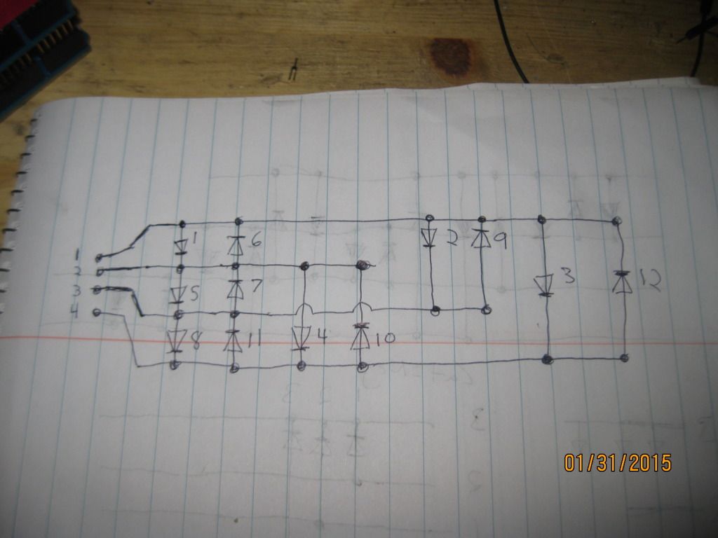

Ye Olde Charlieplex schematic:
I just noticed that the 85 only has 3 analog inputs and I'm only using 1. Not sure if that's part of the problem...
I figured I'd change the thread title because this is what It's morphed into.
New matrix schematic:
In the code where the pins are listed in order does the cathode or anode go first?

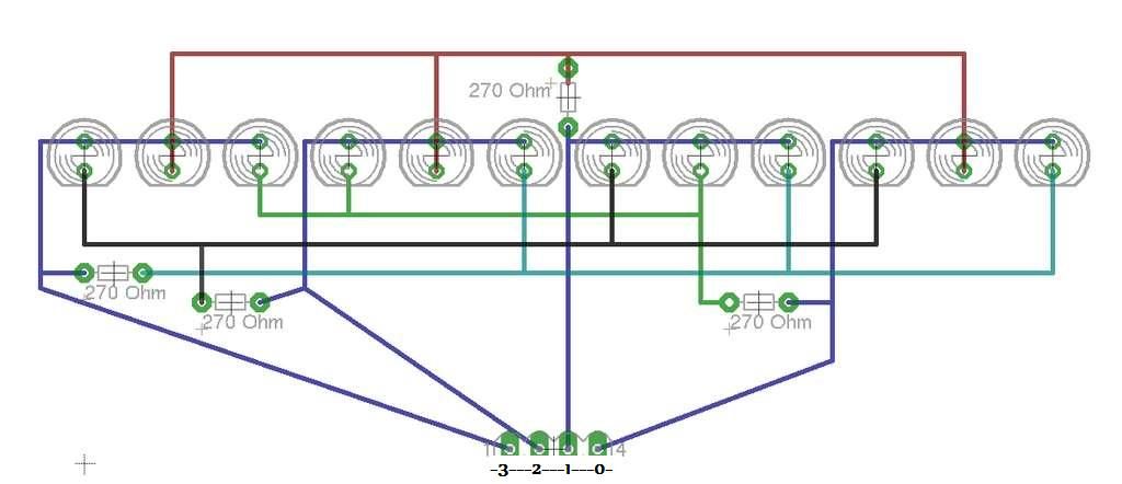

6  Using Arduino / LEDs and Multiplexing / Charlieplexing a row of LED's on: August 21, 2012, 07:18:53 pm
Wow, I really hate to bump my own thread but if anyone has any parts recommendations I need to get them on the way...
Her project is a sort of animated atom with 12 neutrons and 12 protons in the nucleus. She was thinking two different colors and having them blink in a pattern. The first shell will have 8 leds and only 2 will be illuminated at once, also in a blinking pattern. The 2nd shell will have 12 leds with 8 illuminated at once in a pattern similar to the 1st and the 3rd shell will have 8 leds with 2 illuminated.  I hope that makes sense. I don't really have time to do a lot of searching so I was hoping for some help.
I ordered abut 200 leds from ebay a while back and my daughter thought the project up and has already built some of the "hardware"  smiley-red
She's pretty good at soldering because she makes jewelry from old computer board parts  smiley so she'll handle most of the work. It just came at a bad time because this week is REALLY busy at work so I don't have much free time. I need to get in the bed soon...
Anyway, I have a couple of 328 chips that aren't doing anything and I have experimented a little bit with multiplexing on attiny 85's but that's about it.
Any help would be GREATLY APPRECIATED!
