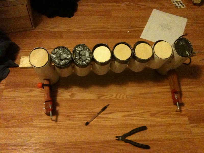

Thanks for the reply.  I've seen these LED matrix boxes...I'm looking for something pretty different.   Let me clarify more what I need:
Here is a picture of one of the triggers:
I have a pen in there so you can get a general idea of the size.  Now there are four of those around the stage and connected with DB9 cables to the midi controller.  So on each of those individual pads, I want to mount an LED that will turn on when activated that pad has been activated and is receiving the MIDI feedback messages from ableton...
I'll have the Arduino in a rack and connect the LEDS with their own DB9 cables.
