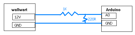

134  Using Arduino / Project Guidance / Re: rechargable batteries for uninterruptible power supply on: October 22, 2012, 07:17:41 am
something like this, I meant
Code:
digitalWrite(5, HIGH); // close the circuit, now A1 gets battery voltage
delay(500);  // give relais some time
int measure_voltage = analogRead(A1);  // now read the voltage
And...
voltage divider  factor  =  220/1220 = 0.18
Battery full: 9V; 9V *0.18 = 1.62V; 1.62V *1023/5V = 331 (=measure_voltage)
Now map(0,331,0,1000) (ca. multiply with 3, but there is an arduino function called map) and get 0.1% steps (promille) of battery voltage
Code:
int battery_voltage = map(measure_voltage,0,331,0,1000)
What do you think, good idea?
135  Using Arduino / Project Guidance / Re: rechargable batteries for uninterruptible power supply on: October 22, 2012, 05:47:57 am
Ah now I understand the problem: The batteries need to be controlled so that they work when they are needed - so that you can rely on them.
 However, I don't understand how you want to use the relais exactly.
Maybe a voltage divider can be attached to the battery and then the analog reading - exactly like I have drawn it near the wall-wart power supply. Additionally, a relais can be used to switch reading battery voltage and then to open it again. This can happen via a digital output once in a minute,e.g.
