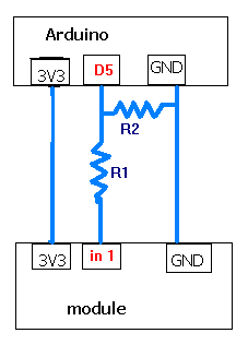

142  Using Arduino / Project Guidance / Re: Control all 3.3V devices with 5V Arduino ? on: October 19, 2012, 05:45:27 pm
Ok, Could I also use 10K resistors? That would minimize the current drawn.
And, thank you very much for the explanation.
143  Using Arduino / Project Guidance / Re: Control all 3.3V devices with 5V Arduino ? on: October 19, 2012, 05:35:12 pm
You should always read the data sheet for these modules, some will take 5v because the chips is able to or the module has an inbuilt voltage divider.
The modules 3.3v high outputs can go direct to the arduino as the digital inputs see anything over 3v as high.
Yeah, I knew that already smiley-wink
The question is using those 3.3V modules not having an intern voltage divider and as output.

145  Using Arduino / Project Guidance / Re: Control all 3.3V devices with 5V Arduino ? on: October 19, 2012, 05:24:40 pm
Unfortunately, I have no potentiometer, but resistors:
220Ω
1KΩ
10KΩ
each 10 times, not more.
I think 40mA is max current drawn per pin
So I have an input device whose current drawn can be ignored, 2*220Ω+1*220Ω=3*220Ω=660Ω (=R1+R2).
I = 5V/660Ω = 7.5mA
Is calculation correct?
However, that means I could also use 10KΩ because current drawn gets less with increasing resistor value (?)
146  Using Arduino / Project Guidance / Re: Control all 3.3V devices with 5V Arduino ? on: October 19, 2012, 05:04:37 pm
Aaaahrg, I mixed the order of the resitors!!
This is corrected:
My question is whether it is really that simple?!

148  Using Arduino / Project Guidance / Control all 3.3V devices with 5V Arduino ? on: October 19, 2012, 04:45:22 pm
Hello,
there are many 3.3V modules for other microcontrollers out there (e.g. there are Arduinos with 3.3V supply voltage).
To work with them, I though of this simple construction:
with:
R2 = 2*R1
Then we have
3.3V = 5V * R2/(R1+R2)
3.3V = 5V * 2*R1/(R1+2*R1)
3.3V = 5V * 2*R1/(3*R1)
3.3V = 5V * 2/3, check OK
So I can use for example:
 R1 = 220Ω
 R2 = 220Ω+220Ω (series switch)
Is this  thinking correct? Or is there any mistake. Then it is very easy because you only need one type of resistor and double it by doing series .
Thank you very much. Then I know whether I can buy all the 3.3V modules smiley
