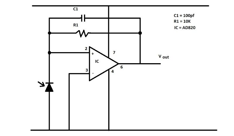

12  Using Arduino / General Electronics / Re: Measuring PAR (photosynthetic active radiation) on: April 02, 2013, 08:38:47 am
Ok, I've read the document...a few times, hehe. And came to this conclusion...
I should use a JFET Op-amp because of the low noise, which is rail-to-rail and through hole (because I don't have a reflow oven). It also has to have a single voltage supply (5V) so I chose the AD820 for this...
Also made a diagram, instead of picking one from the internet (won't be doing that again smiley-wink )
The feedback resistor value and capacitor value are still a guess, but I think the filter is in the right place...Please correct me if I'm wrong.
13  Using Arduino / General Electronics / Re: Measuring PAR (photosynthetic active radiation) on: April 02, 2013, 07:11:21 am
Well you could try a filter with a resistor and capacitor but it would be good to use a proper sensor and a realistic value of feed back resistor.
I know a decent sensor would be better, but a PAR sensor is in the price range of 180$. I thought the geniuses here would come up with a nice diagram that I could actually use...
Knowing that the feedback resistor is way to much, but since you guys love gobbling up those diagrams, and this was one I could find in a whim...I posted this one, not expecting the funny replies...Please give Erdin a dollar cause he's SOOO funny  smiley-razz
Any other ideas how I could measure PAR without the op-amp?
Thank you for the useful link. Saw it earlier this weekend, but didn't know what to make of all those diagrams and explanations... Still don't actually, that's why I came here to learn something...So just for the heck of it I'm going to try my best to decipher the 5min course (it already took me a whole lot longer smiley-wink ) and come back with what i've learned. And then please comment on this, even if it's just to make fun! Because that just means one has read my jibberjabber and understands it better then I do smiley-wink
Thank you all for reading and like I said earlier on this forum... I'm not going to give up that easy!
14  Using Arduino / General Electronics / Re: Measuring PAR (photosynthetic active radiation) on: April 02, 2013, 05:11:27 am
I think that using a 320M resistor is very stupid.
Thank you for pointing that out...
Your problems have nothing to do with step side and everything to do with picking up mains interference.
Could you tell me how I can smooth out the 'mains interference'? Is this why the value's jump up and down?
15  Using Arduino / General Electronics / Measuring PAR (photosynthetic active radiation) on: April 02, 2013, 04:32:35 am
Hello everyone,
For a new project (actually a add-on for an old one -> link) I'm building a PAR meter. The difference between measuring PAR and Lumen, for example is the spectrum being analysed is different. Since PAR sensors are quite expensive I've found a way to do it with led's using 'Mims discovery/effect'...
There's also a book called 'Atmospheric Monitoring With Arduino' where one can build a simple photometer with some LED's and use this to measure the PAR spectrum (400nm - 700nm), but I don't know if I'm allowed to post the schematic and/or code from this project here...correct me if I'm wrong smiley-wink
When I attach a led to my multimeter and set this to measure mV it measures about 80mV when I turn on a light, so the LED is producing a voltage...Yeah... Thank you Forrest!! smiley
When connected to the arduino the output starts to swing going from 230 to 0 and then back up...I think it has something to do with the amount of mV the arduino can register --> 5V/1023 = 0.004887586V = 4mV per step. So I've read some threads on this forum and others and started thinking about it.
First I have to step up the voltage with a linear rail-to-rail op-amp and second stabelise the reading by using a capacitor. Now my electronic skill set isn't much to write home about and this is why I need some help...
I've found several diagrams which would do the trick, but none of them tell me which kind of op-amp and capacitor I should use...
What do you guys/galls think?
