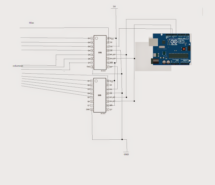

3  Using Arduino / LEDs and Multiplexing / HELP with 5x9 Led matrix with two 74hc595 on: May 22, 2013, 08:37:41 am
I've some time working in a matrix of 5 rows and 9 columns. And I've run into the problem that I can not show a circle. I used two shift registers. In the first 5 outputs of the first 74hc595 I connected the 5 rows and in the remaining, part of the columns. The rest of the columns it connected to another 74hc595 that is in cascade with the first.

I can not showing anything and I do not understand. I've looked at a lot of places: instructables, some forums even arduino, and nothing. I do not get to create a sketch that I work with my array. If anyone can help me to find the fault I would appreciate it.
Also I try using this other sketch, to learn how it works, but I do not get out well. In this I think the problem is that the accounts have not done well. The sketch is based on the first LED light, then the next in the row and then when it reach the end go to the next line and so all the time.
