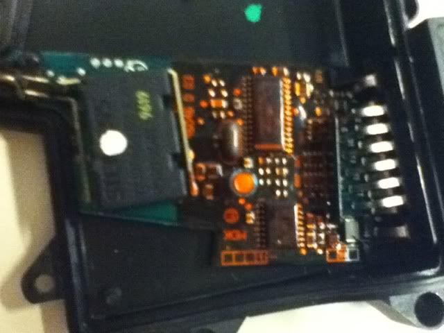

4  Using Arduino / Motors, Mechanics, and Power / Re: Help with a VW Golf power window motor on: April 13, 2012, 07:43:20 am
- If I let the direction wire touch the negative pole, the motor turns anticlockwise, as expected, but it doesn't alwasy stop when I disconnect the wire from the negative pole, sometimes it keeps running, sometimes it stops. When it keeps running, it will stop if I let the direction wire touch the 5 volts.
On a second thought, this behaviour might be the one-push-to-fully-close-window feature that some cars have, the driver holds the button shut for a little longer and the motor keeps running until the window fully closes or the driver hits the switch again.
5  Using Arduino / Motors, Mechanics, and Power / Help with a VW Golf power window motor on: April 13, 2012, 05:40:37 am
hi,
I'm playing with the power window circuit of a 1994 Volkswagen Golf III, to drive its 12v DC motor using my arduino mega.
The VW Golf high level wiring diagrams can be read here, on page 35, but I couldn't find the datasheet of both chips on the driver board (I know, useless picture, but it was the best I could get out of my cell phone)
The chips are:
- a Microchip "FHS03 00129" "6D56G" "LLNB9610"
- an unknown manufacturer's "9614VGC" "6 66 30"  "00080"
According to what I could understand from the wiring diagram here's how I connected the 12v battery, a 5v source that mimics what the arduino would eventually supply, and the board connector:
- Now, when I connect the battery terminals only to the wires number 1 and 15, the motor is still, as expected (needs "enable" and "direction").
- When I let the direction wire (number 11) touch the USB port positive or negative pole, the motor is still as expected (needs "enable").
- Then I let the hotkey wire (black/yellow, number 7) touch the 5 volts from a computer usb port with common ground with the battery (something that sounds like "I turn the key on on the car"), the motor is still as expected (needs "direction").
- Now (it doesn't matter whether I keep the hotkey wire connected to 5v or not), if I let the direction wire touch the 5 volts positive pole the motor turns clockwise, and when I disconnect the direction wire the motor gets still, as expected.
Now I'd like to connect an arduino pin in place of the 5 volts usb cable, to feed the voltage needed to the direction wire (I just hope the motor will reliably stop from the anticlockwise position feeding it 5 volts for a short period of time), my question is: what it's best to do to protect the arduino in this scenario ? should I be using a diod to prevent current flowing backwards from the motor on the pin wire (it might be something the chips on the board are already there for, but since I can't get their datasheets I'll never know), or should I do something else ?
thanks and best regards,
andrea

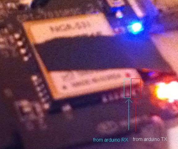

9  Using Arduino / Networking, Protocols, and Devices / Re: Gps ngr-531 and arduino mega on: July 07, 2011, 02:27:06 pm
For a preliminary test to see if I could get nmea data out of it, on these small pins you can see in this blurry picture, glue was safer
safer, but not effective, in that the wires were not touching the pins anyway, as I've just found out. In fact now I'll have to go shopping for the smallest iron tip I can find, because the good news is I wasn't that wrong in my thinking: connecting tx to rxa and rx to txb as described in my earlier post, and the common ground you've suggested, got me the data:
this is with the gps receiver still looking for satellites, in the upper right is the VisualGPSXP (gps receiver windows utility) window displaying live data from the gps receiver via bluetooth, and in the lower right the same live data displayed on the arduino serial monitor, with me connecting the tx and rx wires from the arduino to the ngr-531 chip by hand.
thanks for your precious support, Paul
andrea
10  Using Arduino / Networking, Protocols, and Devices / Re: Gps ngr-531 and arduino mega on: July 07, 2011, 08:37:10 am
Thanks PaulS:
I've changed the code to use one of the hardware serial port (number 3) and a common ground between arduino and the gps: the code now loads with no problem (thanks), still no sign from the gps on the serial monitor (but I'm still in the office), I'll take it outside in a couple of hours and try again.
no kidding on the glue, the other option available at the moment was solder, that would have meant destroy the little chip right away.
andrea
11  Using Arduino / Networking, Protocols, and Devices / Gps ngr-531 and arduino mega on: July 07, 2011, 07:22:52 am
I've got a small bluetooth gps receiver based on the ngr-531 chip, that I'd like to connect to my arduino mega to receive nmea data. I'm a total newbie on electronics in general so forgive the silliness of my questions. First, I've found the ngr-531 chip specs here:
http://www.scribd.com/doc/51133835/gps-navius
and thought that pin 7 and 8 (TXA and RXA), on page 8/15 of the manual, had to be interesting: I've carefully hot glued two wires on these pins and put them into my arduino mega pin 0 and 1 (RX and TX), then I've opened the NewSoftSerialTest sketch, modified the second line
NewSoftSerial mySerial(2,3);
into
NewSoftSerial mySerial(0,1);
and modified all baud rates to 9600, and finally I've loaded the code into the arduino. The gps receiver gets power out of its own battery (3,7v Nokia battery) while the arduino is powered by my laptop usb port, so the tx and rx wires are the only connection between them.
Once the code gets loaded, the serial monitor shows the code greeting message "Goodnight moon!", and nothing else. I've made a couple of tests, swapping the wires and playing with the baud rates, but still nothing comes out of the gps receiver (which is supposedly good for it's the one I use from time to time with my nokia n70 tomtom). Here are my questions:
- am I making things too simple by thinking that just hooking the gps chip TXA and RXA to arduino's RX and TX would do the trick ?
- do I need to connect the arduino and gps receiver grounds together ? (actually it was one of my tests, but when I did that I got a sync error from the arduino software when loading the code)
- do a gps receiver usually send out serial messages while trying (and not succeding) to get a satellite link ? I'm asking this because all the tests have been done in a office room, with no clear path to the sky, and the receiver had probably not been able to get a satellite link.
Thanks,
andrea
