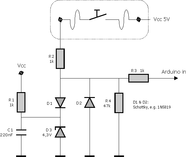

4  Topics / Home Automation and Networked Objects / Re: Connecting arduino to existing house wiring on: April 18, 2014, 04:34:37 am
This schematic is not made by me, but by someone designing harddisk controllers (a professional).
The idea is:
D2 is for negative spikes.
R2 and R3 are for power absorbing of high energy spikes.
R4 is for pull down.
R1 is 'opening' D3. Zeners are very slow, they could be damaged by a high energy spike.
D1 is for positive spikes, this spike is grounded via D3. Because of the slowness of D3, C1 is for capturing the first 'start of the spike'.
Maybe it's a bit overdone for home-purposes, but I've had some troubles with spikes conducted by switching power supplies and TL lighting, which was all gone with this solution.
With this, the voltage to the Arduino input will never be over 5V, although I don't know what the maximum input voltage is?
Otherwise it might be indeed an idea for a higher D3 for less power consumption.
5  Topics / Home Automation and Networked Objects / Re: Connecting arduino to existing house wiring on: April 17, 2014, 01:12:42 pm
I know Polyglot doesn't like the idea, but depending on where you live, wiring is not a big issue.
If we forget all the legal stuff, this is my setup (all credits for the schematic to Vincent Himpe, alias free_electron):
This is working for quite a while at my home, no failure at all.
All with ordinary wires, though I admit that shielded wires would be preferrable. Total current consumption with closed switch is aprox. 2 mA.
