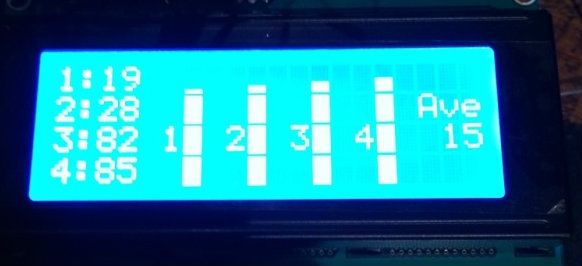

12  Using Arduino / Programming Questions / [Solved] Random() gives out-of-bounds results on: December 16, 2012, 12:44:37 pm
I suspect that the 82 is the value 8 only partially overwriting a previous value of 12 or 22 or 32.
Add a print of a space after each print of a value and see whether that still happens.
Genius! I've added an lcd.clear(); to the loop and so far it seems to be working fine... Thank you! smiley-grin
13  Using Arduino / Programming Questions / Random() gives out-of-bounds results on: December 16, 2012, 12:35:36 pm
My code currently calculates 4 random numbers, from 0-32 by calling "random(33)". It then displays these and the average on an LCD display.
However, I keep getting numbers higher than 32, which sometimes affects the average and sometimes doesn't)

Here's a sample output:
