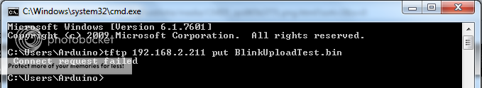

5  Using Arduino / Networking, Protocols, and Devices / Re: Uploading Sketch On Ethernet Board Through Network on: July 03, 2013, 11:31:00 pm
Quote
Are you really sure you have configured your network with a network mask of 255.0.0.0?
You're correct, my Network Mask is 255.255.255.0. The addresses you saw in my previous post were the default addresses coded into the program, not the addresses that I actually used when trying to upload.
Thank you for the help. You were correct about me needing to specify my complete path. I no longer saw the error. However, after including the pathway, I simply got nothing. Just another prompt to enter more instructions to cmd (C:\Users\Arduino>):
I'm not sure if the command was successful or if it did nothing. Regardless, I moved onto the next step and entered the tftp put request to upload the sketch to the board, but got the following message instead (the IP address in the command is supposed to be the one going into the Ethernet board. I got that address by plugging the Ethernet cord into my laptop, turning the Wifi off, and using the cmd window to read my IP Address. Then I took the Ethernet cable and plugged it into the Ethernet board and turned my Wifi back on):
"The -i switch indicates you want to send the file in binary form" (from Freetronics). I reset my Ethernet board to complete the upload, but the file was not transferred to it.
So I decided to restart the process and go through all the steps up to the tftp put request. At that point, I closed the cmd session and started a new one, immediately trying to use the tftp put request. I did this because the instructions on Freetronics, at the point of using the tftp put, say:
Quote
1. Open a console command line window.
2. Perform the upload by typing:
    tftp -i <Arduino IP address> put <filename>.bin
When the first line said to open a console command line window, it sounds to me like it's implying the previous command line window (cmd session) was closed. But doing that simply gave me a "Connect request failed" line:
I'm not sure if that error is due to the fact that I did not go through the previous steps in the same session, and simply began the session with a tftp put command, or maybe there is a problem trying to connect to the Ethernet board (wrong IP address, etc).

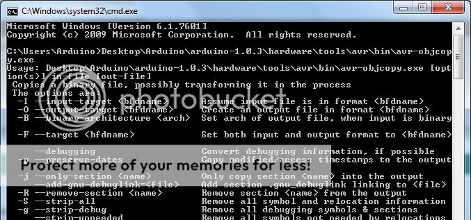

6  Using Arduino / Networking, Protocols, and Devices / Uploading Sketch On Ethernet Board Through Network on: July 03, 2013, 03:59:36 am
Hello, I am trying to figure out how to upload a sketch to my Arduino Ethernet (w/ POE) through an ethernet cable based on steps from Freetronics (url: http://www.freetronics.com/pages/how-to-upload-a-sketch-to-your-arduino-via-a-network#.UdOeAm3hdy8).
My USBTinyISP v3.0 was able to burn the bootloader no problem using the Arduino-TFTPBoot from Github (url: https://github.com/freetronics/arduino-tftpboot/downloads).
The "WriteNetworkSettings" example from that library needs to configure the network. On my Windows 7, I went to the cmd Prompt to get my network addresses:
What the Library Asks For                    What I Equate it to In cmd
Gateway IP Address                            Default Gateway
Arduino Device IP Address                   IPv4 Address
Subnet Mask                                      Subnet Mask
Then I uploaded the WriteNetworkSettings example code, and reburned the bootloader (part of the steps from Freetronics)
Code:
#include <EEPROM.h>
uint8_t NetworkSettings[] = {
  0x55, 0xAA, // Signature
  0xFF, // Image Status (bad)
  // EEPROM block starts here
  10,1,1,1,                       // Gateway IP address
  255,0,0,0,                      // Subnet mask
  0x12,0x34,0x45,0x78,0x9A,0xBC,  // MAC address
  10,1,1,20,                      // Arduino device IP address
  for (int address = 0; address < sizeof(NetworkSettings)/sizeof(uint8_t); address++) {
    EEPROM.write(address, NetworkSettings[address]);
  pinMode(9, OUTPUT);
  digitalWrite(9, HIGH);
  delay(100);
  digitalWrite(9, LOW);
  delay(100);
To check that my computer is connecting to the Ethernet board, I pinged the Ethernet board (I believe I'm pinging the correct device. I ping the IP Address my computer uses when I turn off the WiFi and use the Ethernet cord; the same one which I later plug into the Ethernet board).
I then returned to 'cmd' and typed in the path to my avr-object and got a list of options:
...and so forth. Which I believe is good since it's not an error.
From there I put in the path to my test sketch, but I got the following error:
I'm not sure what that error means, but it's holding me up from moving forward. Thanks
