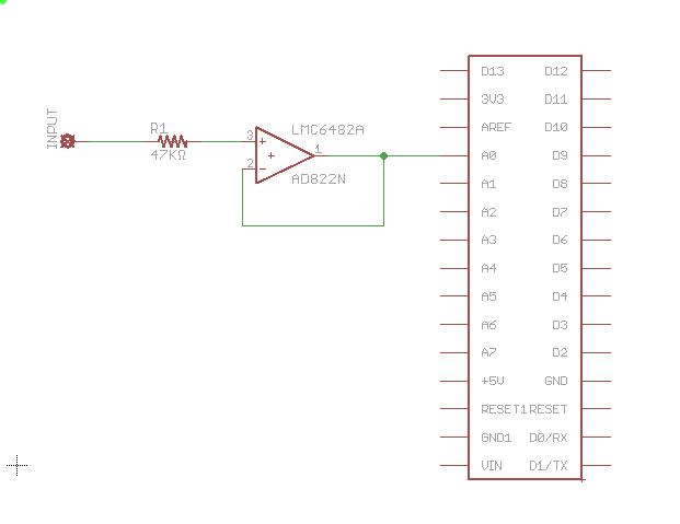

1  Using Arduino / Project Guidance / Re: Protecting Arduino inputs from external inputs on: December 31, 2013, 08:11:36 pm
Thanks buddy.  I made some modifications tonight.  I put a 0.1uF across the power pins of the op amp and it made no difference.  I then added a 0.1uF across the feed back resistor (between pins 1 & 2 in my diagram above) and that fixed it.  Smooth steady voltage now.  Thank you for that help.
Now that the voltage is stable I can see it's a little off though.  So typically when I feed it the Arduino typically has a very small margin of error.  I build lots of these testing modules if you will and on average I have to feed 0.94 volts for the Arduino to read 0.90 volts.  Some Arduinos require 0.94, some 0.95 and the highest I've had is 0.96 volts.  However going through the op amp I see I have to feed it 1.04 volts to for the Arduino to register 0.90 volts.   I know op amps can do scaling and its got me thinking am I inadvertently scaling the voltage without meaning to?  How do I correct this difference?  I need the Arduino to correctly read the voltage for my projects.
Thanks again for the input so far.
Malcolm
2  Using Arduino / Project Guidance / Re: Protecting Arduino inputs from external inputs on: December 31, 2013, 10:46:10 am
1. Make sure you have a decoupling capacitor across the power pins of the op amp. 0.1uF ceramic should be fine.
Ahh didn't even know about that capacitor.  Will see what I can get added in there.  It's using the 5 volt power source from the Arduino.  I take it that's a noise supply?
2. Try connecting a capacitor (0.1uF of 0.01uF) in parallel with the 47K feedback resistor.
Will try that too.
3. Check your wiring.
That's all correct.  I ordered new circuit boards from a board house to include the op amps.  They take about a month to arrive, hence the delay.

9  Using Arduino / Project Guidance / Re: Protecting Arduino inputs from external inputs on: November 13, 2013, 03:32:47 pm
SirNickity thank you for the response.   I thought the 47K input resistor would protect the op amp from over voltages the way the arduino does but you bring up a good point there.
Here is the data sheet for the op amp
http://www.mouser.com/ds/2/282/snos674c-122978.pdf
It does say it can handle up to 15 volts but that's supply.  I'm not really sure what happens though if the supply has 5 volts (coming from the +5V out of the arduino) and the input goes to 12 volts?
I would like to avoid a voltage divider if at all possible.  My requirements are to have as minimal impact on the source I'm monitoring and also read it as accurately as possible.  I'm aware of floating input when nothing is connected and in this project that's completely acceptable as I will always have something connected.  I do wonder if I need a 5.1 volt zener diode after that 47K resistor connected to ground so if I accidentally put 12 volts on that input instead of the 0-5 volts it doesn't blow the op amp.  Assuming that op amp will blow.  I still need to decipher that data sheet.
10  Using Arduino / Project Guidance / Re: Protecting Arduino inputs from external inputs on: November 13, 2013, 12:22:25 pm
If you do not need scaling, then you just connect your input voltage through a 47k resistor to the "+" or non-inverting input of one op-amp and the output - which of course goes to the Arduino - through another 47k resistor to the "-" or inverting input.  As the LM324 is running from the same 5V as the Arduino, its output cannot exceed that.  There is a problem however - the LM324 cannot drive its output to the full supply voltage anyway, so you probably need something like a LMC6482 or LMC6484.
Paul I picked up the LMC6482 as you had suggested and this is how I wired it up.  I'm not sure it's right because reading your description you say "through another 47K resistor" at one point but I'm not sure where you are referencing?  I've been googling around and when I see op amps connected up a lot of them have additional resistors and capacitors around them and I'm not entirely sure I understand why.  Some look like because they are scaling the output differently from the input and others look like they are conditioning or cleaning up inputs.  Such as taking a noise sine wave input and making it a clean square wave output etc.  I just want to get a more informed opinion on this.  Here's how I have it wired up now.
