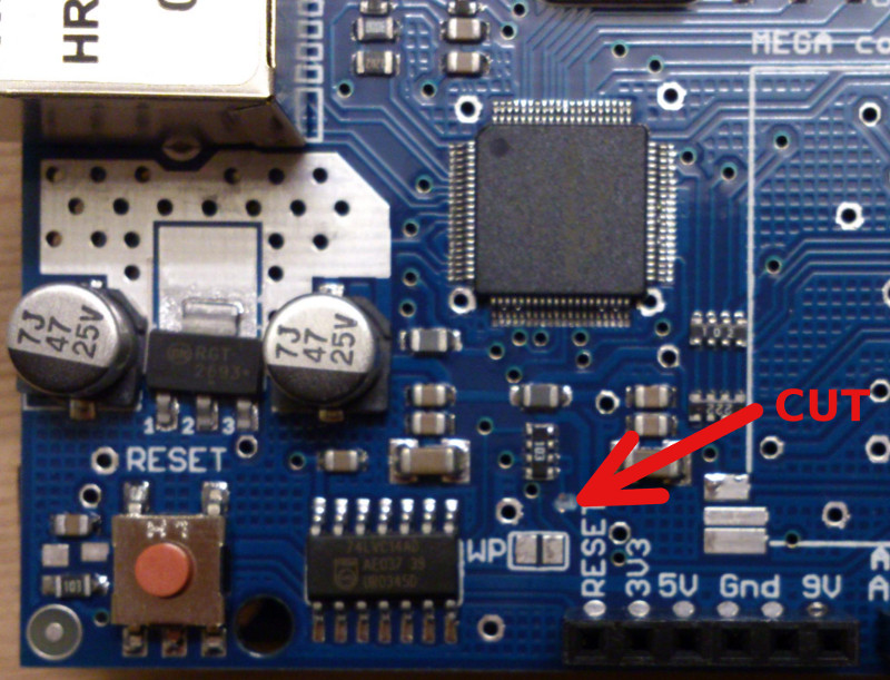

9  Products / Arduino Due / Using a V5 ethernet shield with Due on: August 20, 2013, 10:22:59 pm
I was looking for an ethernet shield for my Due and discovered that only the latest version ("R3" or "V6") has the IOREF sensing and is therefore safe to use.  The official shield is something like $45, but on Ebay there are a ton of older shields for as little as $10.  I picked up one that was billed as being "Mega compatible," and it turned out to be a version 5.  I took a look at the schematic and determined that there was only one place where 5V touches the Due pins:
Chances are that this wouldn't hurt the Due, given the relatively high value of the pullup resistors.  However, I found a convenient place to cut the trace that connects the pair of resistors to 5V and did so:
If you intend to use those Due pins for sensitive analog work, you might also cut the trace between pins 5 and 6 of the resistor network directly above the other cut point.  Otherwise, A0 and A1 would still be connected by 20K of resistance.  None of the trace cutting will affect using the version 5 shield with other Arduino boards, since those pins only connect to the full-size SD footprint, which can't even be populated without desoldering the microSD socket first.
