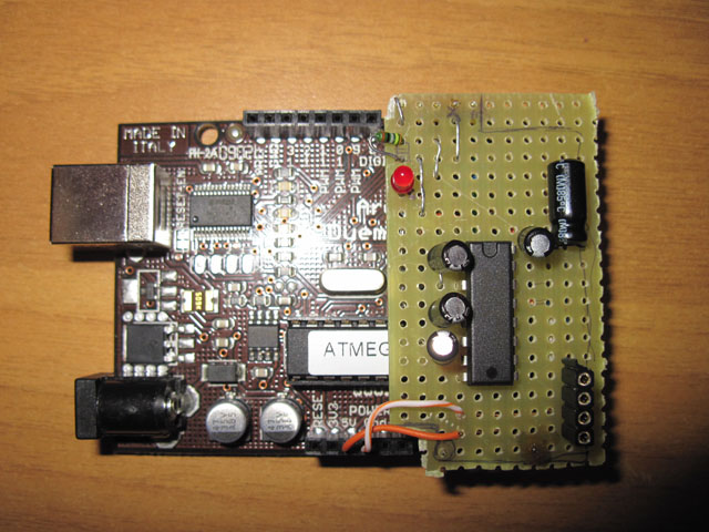

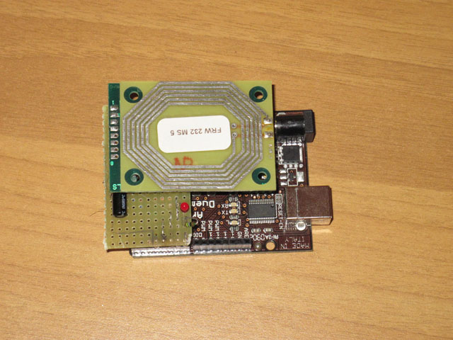

I'm proud to introduce the rfid 13.56MHz shield !!
I'm using a serial module for myfare cards communication.
First i needed to create a shied for max232 because the mifare didn't communicate with arduino serial (thanks uwefed for the suggestion). And I used this schematics.

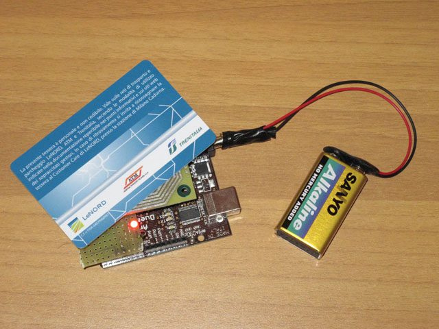

After then i developing a test program, for now when a mifare card is near the module the test led will blink.
The card is an "leNord Itinero", is a ticket for train, and is a mifare 1k card.
I will release other information when all is working well.
Someone is interested to project? any idea of develop? the advantage is form 125khz card is because you can store up to 4kb of data into card divided in few password procetected sectors.
