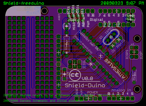

4989  Forum 2005-2010 (read only) / Development / Re: Shield-Duino on: March 25, 2009, 08:21:06 pm
One problem is that the Arduino form-factor is pretty limited on the amount of space you have at the edges for putting connectors, especially if you're trying not to interfere with the "tall" components on the main Arduino board...
4990  Forum 2005-2010 (read only) / Development / Re: Shield-Duino on: March 24, 2009, 03:59:40 pm
Quote
I see no value in all these shields that "bring up" the ICSP headers from the original board
The original (and followon) Zigbee shields use the ICSP header for power (grr.)  Several shields (mostly proto shields?) that pre-date diecimila  use it to extend "RESET" of the arduino to the shield (button, or for bootload-via-shield capability.)  I don't like it either :-(
4991  Forum 2005-2010 (read only) / Development / Re: Shield-Duino on: March 24, 2009, 10:29:24 am
Quote
this could be "multi" core, if designed correctly, right?
Yes, assuming SPI or some multi-drop serial protocol.  But mostly it probably equates to an easy way to make a stock arduino into a "dual core" arduino.
Quote
What about having two set of headers?
So that one could stack an additional shield on top of shielduino.
Yes, that's the plan.  The original arduino shield connectors would stack, and the equivalent connections form the "coprocessor" would go somewhere else.  (next to the proto area in the pcb pictured.)  That lets you add additional shields to the original arduino, but doesn't let you add shields to coprocessor.
4992  Forum 2005-2010 (read only) / Development / Re: Shield-Duino on: March 24, 2009, 02:41:37 am
Works fine if your logged into picasaweb as me :-)
Fixed?  maybe?  It's just a rough draft picture anyway...
4993  Forum 2005-2010 (read only) / Development / Shield-Duino on: March 24, 2009, 12:08:17 am
There are a lot of things that the ATmega CPU on an arduino could be programmed to do, relatively easily, that are a bit ... exclusive ... of having the arduino do other (normal) things.  They might have tight timing requirements, use up large amounts of the available CPU time, use timers in ways that conflict with analogWrite(), and so on.  Multiple servo motors, multiple serial ports, and large display (video or LED) refresh are typical examples.  Yet the Arduino environment is known and understood, and it would seem a shame to require a special purpose shield to do the same thing that an arduino could do.
So... What do you think about putting the basic Arduino core (16MHz Atmega168/etc) ON A SHIELD.  Essentially a "slave" arduino, or an arduino "co-processor" based on Arduino...
It would communicate with the main arduino by serial or SPI.  It could be programmed by running a special "relay" sketch on the main arduino, or by ICSP, or by unplugging the 168 and plugging it into a real arduino.  It would tap power from the main board, as per most shields, and replace the power and usb areas of the normal arduino with a prototyping area for additional circuitry.  The PCB could double as a "reduced" arduino "runtime board." Ardunio shield connectors would stack, and new connectors would show up "elsewhere."   Even mere pin expansion would be reasonable; a shield board with an ATmega8 wouldn't be THAT much more expensive to build than a shield board with a couple if 74hc595s, and it would be a LOT more flexible.
What do you think ?
http://picasaweb.google.com/lh/photo/aNIGofgMSIJ6i17Xtshedg?feat=directlink
