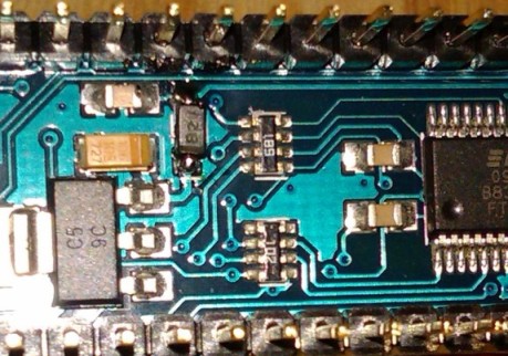

14  Forum 2005-2010 (read only) / Troubleshooting / Re: Arduino Nano kind of dead HELP on: July 12, 2010, 06:09:15 pm
Found the Diodes on Ebay: 25 of them for $2.70 shipped, out the door cost.
So if you need one contact me and I'd be glad to mail you one or two if you pay the $0.44 postage. I only needed 1 of them.
Here is my completed repair picture, the chip is working awesome and is once again protected from stupidity (To an extent) smiley
15  Forum 2005-2010 (read only) / Troubleshooting / Re: Arduino Nano kind of dead HELP on: June 23, 2010, 10:24:35 pm
Yep that was EXACTLY it!
Pulled that Diode made a tiny jumper and my unit is back online via USB power like it never happened.
I may order another diode for it on my next order with Mouser, I just dont want to have to pay shipping for that dumb $0.20 part.
But for now I'm back in action, and I will try not to do anything stupid until I have that diode replaced.
Here is the pic of my repair for others that run into this issue...
