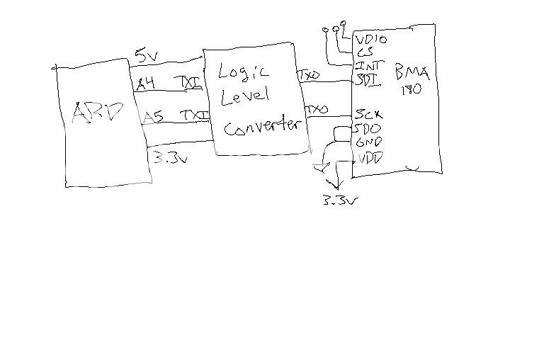

39  Using Arduino / Programming Questions / Arduino + BMA180 Accelerometer on: July 10, 2011, 10:27:51 pm
Hi, I recently got the BMA180 breakout from sparkfun:  http://www.sparkfun.com/products/9723
but i can't seem to figure it out.  I have it hooked up like in the picture below:
So I'm pretty sure I have it hooked up right.
However, when I run the following really simple code, to just check the chip ID and set some values, I don't get proper results for the CHIP ID, it should be 3.

But, if I run that same code but with initializeBMA180() as:
Code:
void initializeBMA180()
  checkID();
  //enableWrite();
  //setFilter();
  //setRange();
I get the proper chip id.  What would be causing this?
Thanks for all and any help!!
