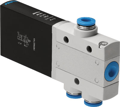

43  Community / Exhibition / Gallery / Imperial March on a fast switching valve on: February 25, 2013, 09:08:42 am
I thought that there have been dozens or Imperial marches played by floppy drives or step motors so I might as well do something new...
The video >>
http://youtu.be/VSOXKtjtdbs
Here is that valve I used
It's a fast switching valve - namely Festo MHE3-MS1H-3/2G-QS-6.
Its switch on time is 2.3 ms and it switches off in 2.8ms - very very impressive piece of hardware and they are pretty pricey - luckily I got it for next to nothing.
The circuit is very simple - just a ULN2004A as a driver for the valve.
