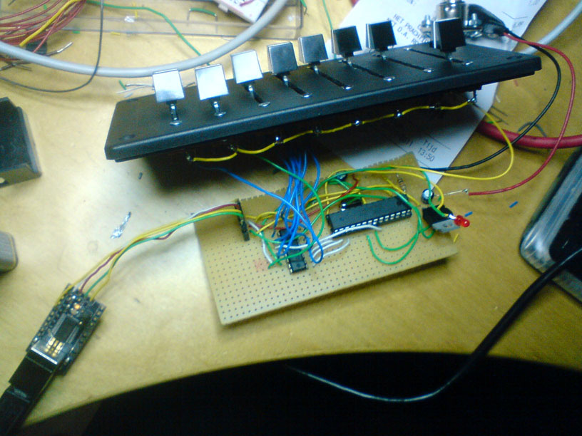

1  Using Arduino / General Electronics / Re: 4051 s0,s1,s2 pin jitter on: January 30, 2011, 09:36:54 pm
no sleep till brooklyn.
the 10K resistors fixed it, thanks
2  Using Arduino / General Electronics / Re: 4051 s0,s1,s2 pin jitter on: January 30, 2011, 09:03:43 pm
aah yes inputs..10k resistors. check.
will do after some sleep, its 3.a.m.
3  Using Arduino / General Electronics / 4051 s0,s1,s2 pin jitter on: January 30, 2011, 08:41:52 pm
i'm building a simple midi fader box with an ATmega328 and 4051 multiplexer.The analog input goes bananas if i get close(with my hand) to the 4051 "input select" pins or their digital inputs on the ATmega. So far(since this pivture was taken) i've added a 103 capacitor between Vcc and GND on the 4051 and a 104 between AREF and GND on the ATmega.
