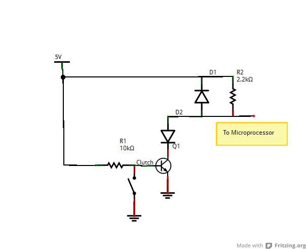

1  Using Arduino / Project Guidance / Advice on signal inverting circuit on: June 14, 2011, 03:15:08 pm
Okay, I have a project for a switch in my car. The problem is the input to the microprocessor in the car has to be a ground signal(low). The switch I am using is normally grounded and opens when activated. So I designed part of this circuit to invert the signal using a transistor. I don't know one thing though. Will the normally grounded switch make the entire circuit grounded once the switch is shut, essentially making the circuit always grounded. I don't know the resistance of the processor's input, so I'm not really sure how to calculate the voltage drop across the resistor. Any help?
