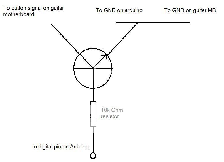

1  Forum 2005-2010 (read only) / Interfacing / Re: ON/OFF switching(newbie warning!) on: December 02, 2010, 12:51:15 pm
Quote
It depends on how the buttons are wired on the original. If you want to make sure there's no interference with the original guitar-shaped controller, you probably will need sort of solid state relay or opto-coupler. If you know have more ideas on what kind of voltages (I guess either 3.3V or 5V) and the polarity used on the buttons you can probably also use simple mosfet. But don't forget in that case the common ground between the Arduino and the the controller.
Well, I found that very interesting, but had no MOSFET...but I made it work with a simple transistor BC547...I´m probably frying something, but sofar it has worked just fine! This is the schematics:
2  Forum 2005-2010 (read only) / Interfacing / Re: ON/OFF switching(newbie warning!) on: December 02, 2010, 04:45:30 am
Quote
The buttons are activated by closing a curcuit of 3,3V to GND between pins on the controller mainboard. Im not sure about the sharing ground thing, I can´t imagine it´s as easy as plugging in a wire between the Arduino GND and the guitar controller GND:-)
But how would you go about this thing with MOSFET´s?

5  Forum 2005-2010 (read only) / Interfacing / ON/OFF switching(newbie warning!) on: December 01, 2010, 08:30:18 am
I´m thinking of a project, where I need to control a number of button presses. It seems, that people before me have done it using solid state relays. I intend to replicate it, but out of pure interest, could it be done using the Arduino(UNO) itself?
The project is a guitar controller, playing Guitar Hero/Rockband on the PS3. The main board of the guitar controller needs the button curcuits closed or open, with it´s own 4,5V. Could the Arduino be used as a solid state relay in this case, or could the current destroy it?
Sorry about the newbie questions...don´t say you weren´t warned:-)...
