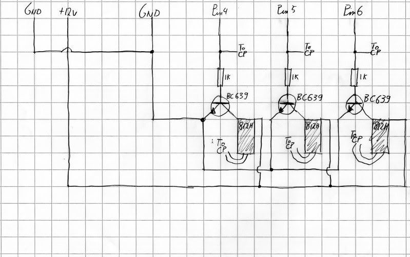

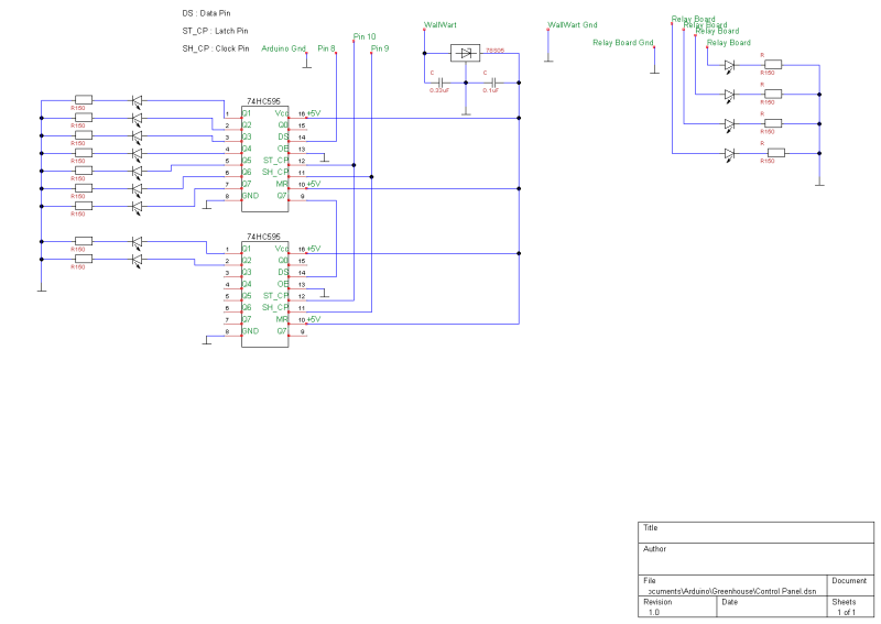

So to get back to the project, I redesigned the circuit to use a pair of shift registers for the control panel and due to that I decided to give the panel it's own voltage regulator so I wouldn't bother the Arduino too much.
Just to be sure I double checked the current tolerances on all the parts of the relay board, I just got a lamp and it draws 2.2A at 250V so that should easily work.
And I swapped the transistors on the relay board for optocouplers as I had a pile of them lying around the house. I checked the current limits and I have about 20mA overhead.

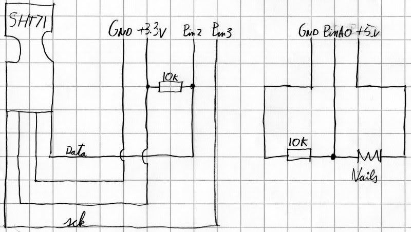

Anyways here's the code and schematics. Parts are en route so physical photos this weekend I hope.

Measuring temperature and humidity is simple with an SHT71 sensor
Controlling with a few relays
I'll be pulling log data over the serial connection and using Gobetwino to store them in as a .csv file
I had most schematics in my head but I drew them up for you guys.
Here are the two sensors, and yes the nail trick I "borrowed" from the Garduino instructable.
Here is the control panel which shows power, status of temperature, humidity and soil moistness. Whether lights, fan or pump are on and mains switches for lights, fan and pump.
And the relay board, and yes I have forgotten about the diodes in this drawing.
