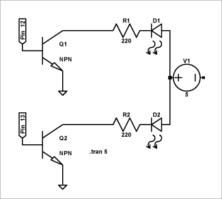

9  Using Arduino / Project Guidance / Re: Brain Machine using existing headsets on: January 28, 2011, 10:57:29 pm
Eyephones: Instead of a "common ground" for the LEDs like you'd think, this has a "common source" - so, just use a couple of small NPN transistors (2n2222 would probably work fine), emitter to ground, collector to the pin for the LED set, and put a base resistor on the base (330 ohm would probably be a good start) and control it with an Arduino digital output.
Headphones: This actually sounds like there is a short somewhere - likely while the plug fits the jack, the plug is in some way custom so that both channels are being fed incorrectly (that is, the contacts interior to the jack are making contact incorrectly with the contacts on the plug). Not sure what you can do about this, except to ohm out the plug and jack, to verify the hypothesis, then if that is correct, look for another jack or another pair of headphones (or a matching plug for the jack, then replace the headphone plug).
Also - note that an Arduino shouldn't be used to try to directly drive speakers - that's a good way to blow Arduino pins. Instead, you need to run the Arduino's output into a small amplifier (like an LM386), then run its output to the headphone jack (you'll need one LM386 for each speaker).
 smiley
cr0sh,
Thanks for your reply.
Does the following circuit diagram come close to what you're suggesting for the eyephones?
As to the amplifier, I have a quad opamp. Could I use two subsets of pins from an opamp as easily as using two LM386's?
