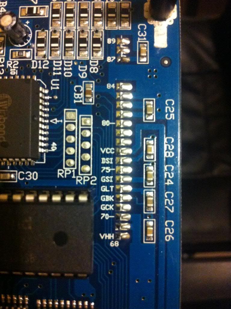

8  Using Arduino / Displays / Arduino To VFD on: April 19, 2012, 05:11:53 pm
I'm trying to hook up a VFD To an Arduino (Arduino Uno), i know it's been done before but i'm unsure how to hook up this one (Not really for a project, just to experiment). It's a DigiPoS WD202 (USB Interface, though the pc recognizes it as a USB To Serial Converter, text can be passed off to the virtual COM Port) with a Winbond chip. Attached are two pictures of the Winbond chip and the interface.
Only just started with working with arduino's so bit of a n00b here  smiley-razz
