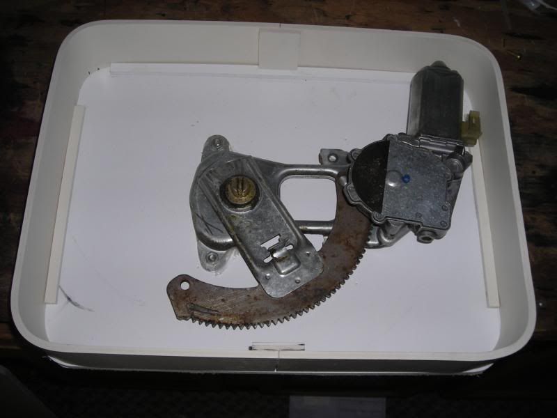

Quote
turning the motor on for a set time and reversing it the same amount of time to open close the valve?
That method might work sometime but I doubt it would work correctly consistently. The problem with the method is, depending on the load, that there is no way to determine the length of time it will take for the door to open or close. Besides that, the time it will take for the door to open or close will also greatly depend of the charge state of the battery. You cannot recharge a "just those ones you buy from the supermarket" battery.
I think you need to rethink this design. Your current one is just too flawed.
- Scotty
15  Using Arduino / Project Guidance / Re: Automated Chicken Feeder - Noob needs help on: March 25, 2014, 06:56:10 am
Welcome to the forums.
At 12v, under no load, that motor would make 1.2 revolutions in 2 seconds. Rather than controlling the length of time to the open or closed positions, I think a better approach would be to sense the open and closed positions and operate the motor until the desired position is reached. What power supply is used for powering the motor? - Scotty
