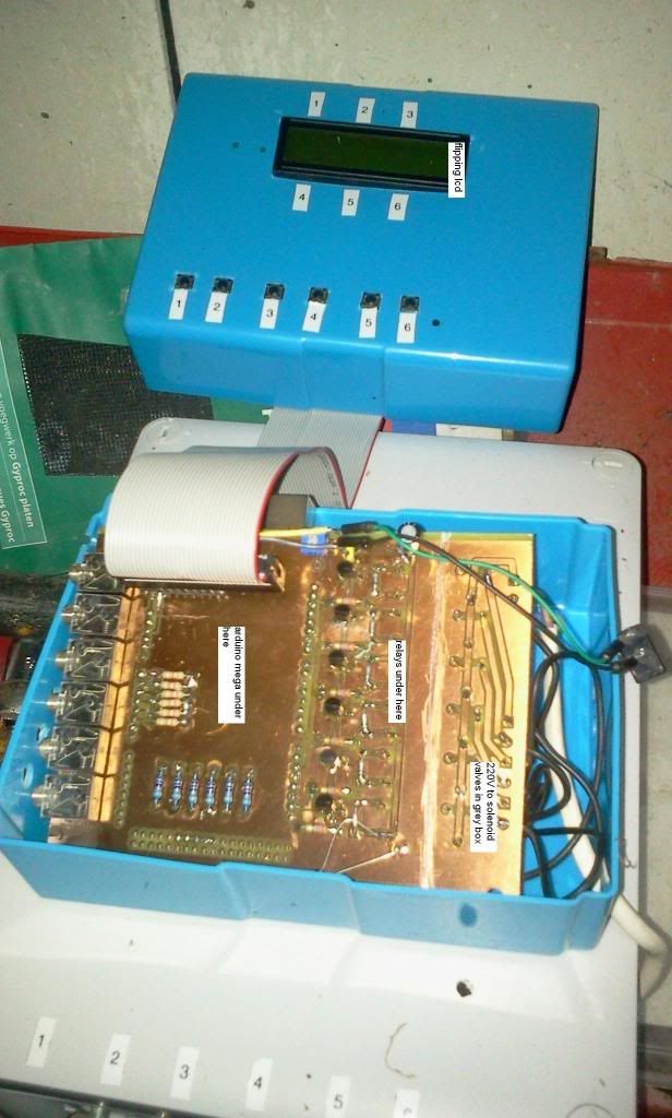

6  Using Arduino / Displays / Re: standard 16*2 standard LCD - flipping - messed up characters on: October 08, 2011, 12:51:00 am
yes flippin = misbehaving (it's mostly be total jibberish, and sometimes I can still read some intended data through it))
that cable is an old style 40 lead IDE cable.
It was added later to see if anything would change if I stretched it, but alas :-)
I've also tried an other LCD, that's not it either.
7  Using Arduino / Displays / Re: standard 16*2 standard LCD - flipping - messed up characters on: October 07, 2011, 12:08:39 pm
exactly!
that's why Im so desperate smiley
I am, as said before, a novice, but I do understand the basics of electricity, relays, arduino, resistors, transistors.
so I think it's wired up the right way.
I don't know a lot about capacitors yet though...
I tried adding capacitors here and there, but it's more guessing than knowledge I guess.
could it just be that the 220v is embedded close to the arduino (on the same "shield", at the business end of the relays)??? I don't know!
here's a quick picture of the pcb if that's any help.
as (I hope) you can see, I damaged the copper fill to Isolate extra, but it didn't work.
again, as long as 220v is off, no problem. When I activate it, most of the time the LCD flips, and if it doesn't, it certainly will when any relay switches off after a cycle.
I guess I'll have to rebuild the thing on a breadboard and see if it persists. If it does, it isn't a hidden fault on the pcb.
8  Using Arduino / Displays / Re: standard 16*2 standard LCD - flipping - messed up characters on: October 07, 2011, 12:19:15 am
Liudr, thats exactly the kind of interference I think is messing with my project.
floresta, 220v goes to solenoid valves. The kind you would probably commonly find in dish washers.
(edit) the problem even occurs when I just turn the 220V ON, not only when the valves activate.
Dirk
9  Using Arduino / Displays / Re: standard 16*2 standard LCD - flipping - messed up characters on: October 06, 2011, 03:45:51 pm
no, I didn't. the only connection between the 220 and the rest of the electronics, would be air, polyester (pcb) and the relays, wich are all intended to be isolating, of course.
I designed the PCB with fritzing, and used a copper fill on the board, so I tought maybe the "220v spark interference" travelled through it, and thus I even tried separating the two areas on the PCB by destroying that copper fill at strategic places.
I also tried to use a higher voltage power supply to the arduino (used 5,5v at first - changed it to 7,5v) , because I thought the relays drew too much power (they're on the same supply), but it didn't help either. It's really when 220v comes in to play that trouble begins.
I haven't tried separating the relays from the pcb to get the source of interference fysically further away from the arduino and display processors. Maybe I should?
I'm thinking I'll have to look for maybe 12 or 24vdc valves. but I bet they'll cost a lot more than the 3€/valve I pay now. since this device should be producable at relatively low cost when working fine, I'm trying to avoid that.
It could mean, though, that I could get rid of the relays all together..
I'm talking to myself at the moment, because I still hope someone has an "aha" moment smiley
10  Using Arduino / Displays / standard 16*2 standard LCD - flipping - messed up characters on: October 06, 2011, 10:39:02 am
hi all,
I turn to this forum, because I'm really desperate.
Natively, I speak dutch, so don't mind poor language please.
I am a novice, by the way, I'm learning as I go. After having played around with some basic Arduino stuff, I decided I'd have a go at something a little more advanced.
The image below is a pretty accurate reproduction of my first test-layout-on-a-breadboard . I worked fine then. It simply measures analog stuff and switches relays (to open some 220 v (low current) valves.) The LCD displays the analog values.
(sorry for the type of image, I think this is clearer than a schema I could make)
It was until I made a PCB of it, that problems began. More specificly, I discovered that it still worked fine UNTIL I connect 220v to the relay contacts. The display flips almost every time I do that, and if it doesn't, it'll flip almost certainly the first time one of the relays re-open (after having been closed).
I guess that the mini-spark that is generated when adding 220v generates interferance (noise?) with one of the graphics chips on the back of the display.
The arduino still performs it's task, but I can't read the display any more (messed up characters).
It is not a programming fault I think, because it works 100% fine before I connect 220vac.
I searched for similar problems on this forum and some other places, and there seem to be a few examples, but none of the solutions were satisfying to me.
- I tried turning off/on the display after every loop (but once the LCD flips, it doesn't listen to those commands any more)
- I tried adding some capacitors at different places, but the problem persists.
any ideas anyone?
thx Turok
