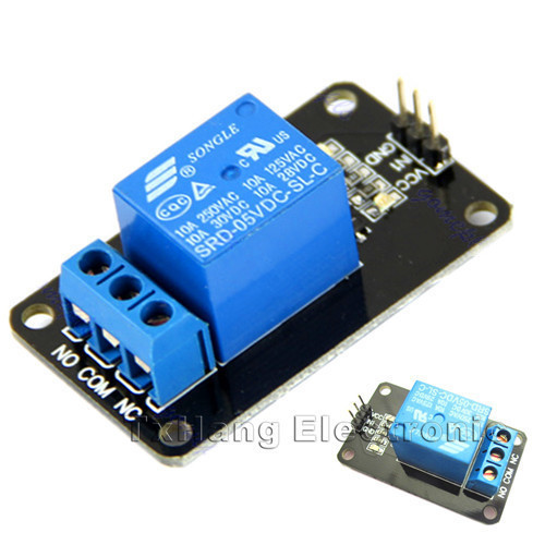

4  Using Arduino / Programming Questions / Re: Relay turns on but not off (SOLVED) on: September 25, 2013, 01:47:32 pm
I was powering the relay and the arduino with separated power suplies.
The relay is connected to a pc Power suply and the arduino to the USB port fropm the pc.
Connecting the arduino to the same power suply as the relay the system turns on and off as supposted.
Thanks for the help
José
5  Using Arduino / Programming Questions / Re: Relay turns on but not off on: September 25, 2013, 01:12:11 pm
Hello
Thank you to you all.
I have solved my problem, it was an energy problem.
Problem solved.
Thanks
José
6  Using Arduino / Programming Questions / Re: Relay turns on but not off on: September 25, 2013, 03:59:56 am
Hello
I did some testing with the blinking example and the relay was turning on and off.
I did not increase the loop delay higher, this could solve the problem.
Regarding the on state with the digitalwrite High, at this point this is not an isue since it should turn on and off as the sensor detects motion.
Now I am at work, later I will do the blinking example and check if all is connected right.
Later I will post further test results.
Thanks for all the help.
José
7  Using Arduino / Programming Questions / Re: Relay turns on but not off on: September 24, 2013, 05:32:06 pm
Yes, exactly.
So the sensor is sending the right signal when it doesn't detect motin, the arduino is changing the stat of the relay, but this one is not changing.
The led onboard gets less brighter, but I don ear the click on the relay and the output ( leds) stay on.
José
8  Using Arduino / Programming Questions / Re: Relay turns on but not off on: September 24, 2013, 05:19:00 pm
Sorry I copied the code form the example,
I have the sensor connected to analog 3, I am sure
José
Ps. I already changed the comment in my program
9  Using Arduino / Programming Questions / Relay turns on but not off (SOLVED) on: September 24, 2013, 05:12:07 pm
Hello to you all
Not sure if this is the righ place to place the question
I have a circuit with one RC-SR501 sensor
controling  one channel relay
My code is
Code:
  AnalogReadSerial
  Reads an analog input on pin 0, prints the result to the serial monitor.
  Attach the center pin of a potentiometer to pin A0, and the outside pins to +5V and ground.
#define rele 2
// the setup routine runs once when you press reset:
  // initialize serial communication at 9600 bits per second:
  pinMode(rele, OUTPUT);
  digitalWrite(rele,HIGH);
// the loop routine runs over and over again forever:
  // read the input on analog pin 0:
  int sensorValue = analogRead(A3);
  // print out the value you read:
  Serial.println(sensorValue);
 if(sensorValue>500){
  digitalWrite(rele, LOW);
  Serial.println("O rele ta on");}
{  digitalWrite(rele, HIGH);
  Serial.println("O rele ta off");}
  delay(300);
}       // delay in between reads for stability
I now the output of the sensor is digital but due to the long wire and the output of the sensor being 3.3v I decided to use it in an analog input.
The readings are ok, and the sensor changes state as it detects motion.
When the program starts the relay is off, as it detects motion it turns on, but it doesn't turn off, even if no motion is detected.
Should I place a pulldown resistor on the digital out chanel nº2 ?
I tought the relay shield already had this pulldown resistor.
Hope I was clear enough.
Any help is apreciated.
Thanks in Advance
José
