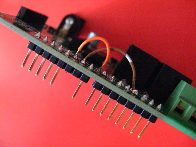

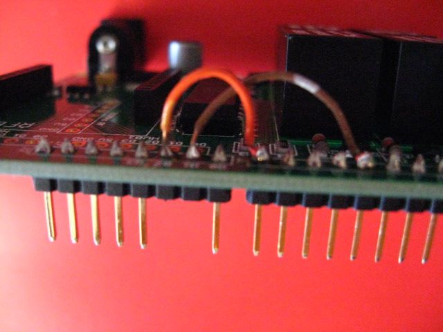

36  Using Arduino / Motors, Mechanics, and Power / Re: Wireing for Arduino/Relay Shield to control a cold cathode tube on: May 15, 2013, 07:13:11 pm
So you removed the pins from D1 and D2 and made a connection to pins 12 and 8, respectively. I noticed on the tiny spec sheet given (with the purchased product) those pins on J1 are grayed out. Does that mean these pins are not being used, a waste of space?
Did you arbitrarily pick these, or is there a reasoning to picking those pairs of pins to connect?
Yes, the grayed-out pads are not committed to the seeedboard, they just help prop it up. I suppose that if they didn't populate them all then some people might freak.
I went with 8 and 12 because they aren't PWM pins, and digital pins 2 and 3 are the hardware interrupt pins.
The Analog pins can be used as digital pins, but they're on the other side of the board (longer jumper.)
Are those the pins in the rectangle labeled J1? If so, what side does the increment start from?
Is pin 12 the SPI library for all Arduino's, even the Mega2560? I think the "Master In Slave Out" (MISO) is 50 or ICSP-1. (Not sure what that means) Reference http://arduino.cc/en/Reference/SPI
ICSP is that group of 6 pins, it's for uploading sketches using USBtinyISP and other similar programmers (no bootloader.)
Is the SPI Library just used for talking to other microcontrolers?
I don't know the 2560.  The Arduino Serial LCDs use SPI, but "serial", to me, = asynchronous serial (8N1); SPI is sync-clocked serial.
I noticed you mentioned:
Quote
If that's inconvenient, one of the seeed board's "D1" terminals could be jumpered to one of the Analog pins instead
Is it correct that those are any of the pins in the designated area marked J4 on the seeed board?
Yes, all D1s are the same, electrically; the same for the others like named - when in doubt, ohm it out (with the power off.)
37  Using Arduino / Motors, Mechanics, and Power / Re: Wireing for Arduino/Relay Shield to control a cold cathode tube on: May 14, 2013, 08:06:34 pm
I made the modification I mentioned in the last post.
So, it's:
Digital pin 7 runs Relay_1
Digital pin 12 runs Relay_2
Digital pin 8 runs Relay_3
Digital pin 4 runs Relay_4
Digital pin 12 is used by SPI libraries.
If that's inconvenient, one of the seeed board's "D1" terminals could be jumpered to one of the Analog pins instead.  They're brought up to the board, but they aren't used by it.  Analog pins can be used as Digital pins, too.
I don't like the short header pins they used.  It sits way too close, double-layering electrical tape on the Arduino USB shell is unacceptable.  I have some headers with longer pins, so I'll re-work it with those - and then put it in a box.
You can't use it for 120vac.  It's not UL-listed (nor TUV, CE Mark); I'm sure they didn't take  "creepages and clearances" or other safety factors into account.
