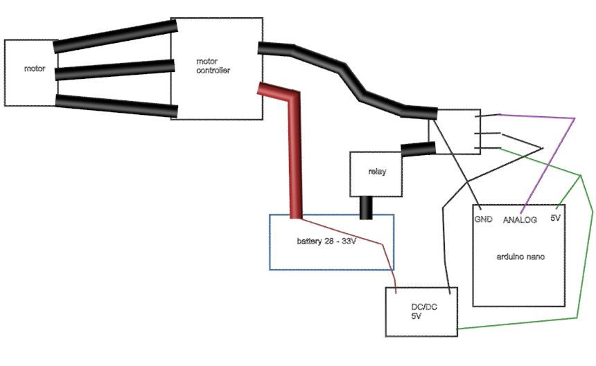

It is connected like this..
The reason that I am measuring the negative side is because I am measuring the voltage of individual cells(with voltage divider for each cell), and for disconnecting the battery i have to disconnect only the common negative side, this is done by a relay... so it disconnects everything... all that components are on the same board, so this was the easiest way to do that...
12  Using Arduino / General Electronics / Re: ACS756 on ebike on: November 09, 2012, 10:46:22 am
I added the capacitors, and the resistor, but the same problem is happening... I tried to move the main wires, and also tried to disconnect the output from the hall going to arduino analog, and that didnt help.. I even disconnected the gnd going to the hall, nothing helped...
Only when i connect the main output wire to the same big pin of the hall current sens that is going "in" , and all other remains connected, there is no problem, but of course there is no measuring either...
I am running out of ideas....  smiley-cry

15  Using Arduino / General Electronics / ACS756 on ebike on: November 08, 2012, 01:03:40 pm
I built an e-bike, with a rc bldc motor, and rc controller, and with arduino i am limiting the current by reading it with a ACS756 hall current sensor.... I connected it without any capacitors or resistors to arduino, and in 90% of the time it is working ok, but in the other 10%... my 1602 lcd resets(like it losses power), and i have strange readings on my other hall switch sensor used to read crank rpm... this happens when there is a quick increase of current to the motor.  I tried to connect the motors controller directly(not throught the ACS756) an everything is fine...
I found that there is a need to use some capacitors, and a resistor, but i was thinking that this is only to smooth the output(which i dont need because the reading is ok for me), or this could fix my problem?
