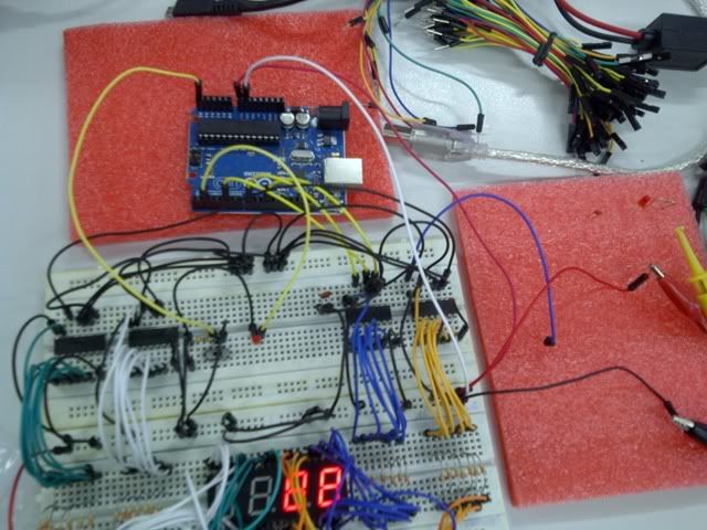

211  Using Arduino / Project Guidance / Re: 7 segment doesn't work properly, no display, no counts! on: March 26, 2012, 12:22:02 am
Here I attach my schematic screen shoot...
Sorry if the size it too large, because I want to make sure the number is clear...
If you have Proteus Simulation, I can give you the soft file...anw it works in the simulation but not in the real circuit...
212  Using Arduino / Project Guidance / Re: 7 segment doesn't work properly, no display, no counts! on: March 25, 2012, 11:40:40 pm
I have tried to make pull down connection as instructed at the website,but still it doesn't work...
The led is blinking but the 7 segment even not on....
Anyone help me???? smiley-cry
213  Using Arduino / Project Guidance / 7 segment doesn't work properly, no display, no counts! on: March 22, 2012, 04:20:51 am
Here I attached you the picture of my project:
It doesn't show proper number as I programmed, maybe you think my code has little mistake but when I implement my code to the simulation using Proteus, it works very ok! So, I assume no mistake in the code.
I use two power supply for this project...
1st power supply for the arduino using usb cable
2nd power supply using ac to dc power supply for the shift register (74HC595)
And I wonder why I turn on and off and on and off repeatedly, the 7segment show weird number (not number exactly)
When I reach more than 4 V for the 2nd power supply, the 7 segment turned off...in fact the normal voltage 2-6V (from datasheet)
When the 7segment doesnt appear, I move my finger near the IC shift register, and the 7segment shows response by lighting dimly..
It is so weird.
Anyone can help me about this weird ?

I am using Arduino Uno, I am doing my project and it use red led...
it is so bright when I connect it from pin 13
it is so dim when I connect it from pin 2
I meausre pin 13 and pin 2 has same voltage (5V) but pin 13 has much more high current...
Hmm, how to solve this? I want my led be bright at all pin...it really give me boundary,,,, smiley-confuse
Why it can happen? is it so or there is wrong with my arduino?
A lot of thanks.
