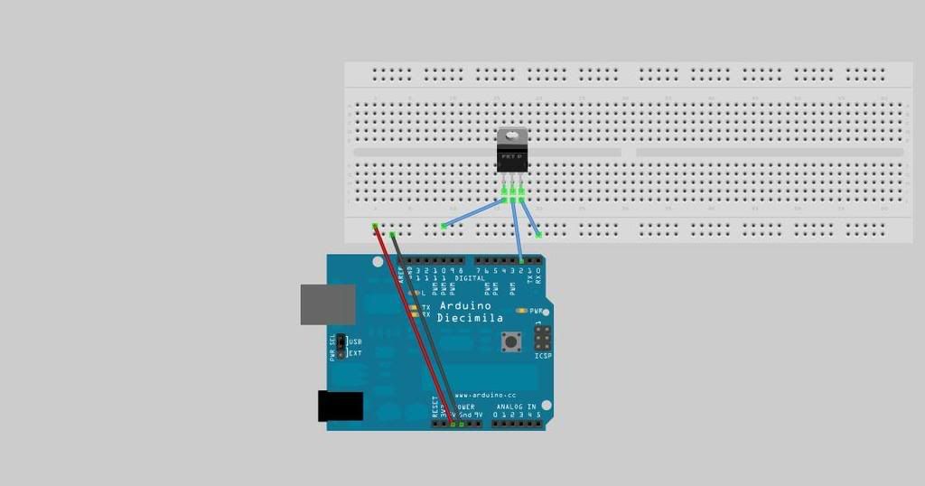

4  Forum 2005-2010 (read only) / Interfacing / Re: Help with Hall Effect/RPM Please! on: December 04, 2008, 12:19:15 pm
Mike, thankyou, thankyou, thankyou! I've spent a ridiculous amount of time sweating over this, and the entire problem was due to my own silly assumptions and not paying attention to the data sheet!
I've rearranged the circuit to have the end leg as the control pin and hey presto, it worked immediately! I do have a bit of an issue with the fact it's a latched sensor, but that's easy to sort out with a bit of code or most likely a new sensor.
I've learned a valuable lesson here that I really should have been able to bring over from my coding experience - don't assume anything!
Should be able to get this thing working within the next couple of days now smiley-grin
Thanks a lot to everyone who contributed, it's been a brilliant help and saved me a lot of headache in the future, I think. No doubt I'll be posting some more queries soon.
Much obliged and indebted,

6  Forum 2005-2010 (read only) / Interfacing / Re: Help with Hall Effect/RPM Please! on: December 04, 2008, 10:09:41 am
OK, let's see if this works:
That's a little diagram of what I've done. I've also tried it with a resistor between the Hall effect sensor and the Arduino pin 2.
I'm pretty sure the interrupt code is correct as I've checked it with the ReadingRPM post on the Arduino playground.
A little note too - I'm not actually counting RPM as I've stated in the title, I just need to count the number of revolutions in total.
Cheers.
Thom
7  Forum 2005-2010 (read only) / Interfacing / Re: Help with Hall Effect/RPM Please! on: December 04, 2008, 05:08:37 am
Cheers for the replies people.
Scootabug: The ReadingRPM page was what I was referring to in the Arduino Playground. I can't really see how the fan/Hall Effect sensor is wired up in the picture, and part of my query was: do I need the resistor between the sensor and the arduino, or was that only for the PC fan (in the ReadingRPM configuration specifically). Also, where does the resistor go? I thought between the control wire and the Arduino? Sorry to sound like such a floundering fish, but I'm not sure where to swim next.
Grumpy_Mike: Damn, these sensors have polarity?! I looked at them and could not see any longer leg, or any sort of distinguishing characteristic for either side/face/edge of the sensor, so assumed they could be placed into the circuit in any orientation - is this incorrect? I guess I should be paying more attention to my datasheets. As I say, I'm a n00b to this (but willing to learn!). Is the 'limiting resistor' what I'm thinking of above?
I'll try to do a simple schematic. But basically the setup is Arduino_5V -> sensor side leg. (Other) side leg -> ground. Middle leg -> Arduino pin. It's essentially the same as the ReadingRPM wiring, but without the LED.
I'm also struggling here slightly with the difference between unipolar, bipolar, latched, latching sensors...
Thanks,
Thom
[edit]
What's the preferred way of posting pics here?
[/edit]
