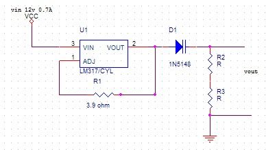

my wrong there,i draw it wrong in orcad but yes,in the real test circuit the 33ohm resistor is in series with the load. and i remove r2 and r3 from the circuit to make sure all the current goes to the battery and to remove all other variables. when i turn on the adapter and measure the voltage of the battery,it goes up to 9.5v and then i turn off the adapter because the battery is rated at 8.4v only (dont have any goggles around).
what is wrong?
or i shouldnt remove r2 and r3 from the circuit?
this is the test circuit but without r2 and r3 and the value of r1 is 33ohm
*will try to build the circuit as you suggested this weekend and hook it up to my arduino and re measure everything

dude,i doesnt get it why you said that this test circuit is wrong..is it wrong in term of application or in term of the value for the resistor?
i took your advice and change the value of the resistor to 33ohm so that the maximum current that can be drawn from the regulator is 1.25/33 = 0.0379A
then i connect the battery t0 the circuit and measure the current drawn by the battery.
its about 0.03A - 0.04A which is the same as when im using 1ohm resistor across adj and output pin.
my conclusion is that this battery are only capable of drawing 0.03-0.04A of currents only. am i right?
so no fast charging for this battery?

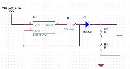

this is the basic circuit that i mean.the voltage that i measure is at vout. the total value of r2 and r3 is 1.8k those 2 resistor are to scale down the voltage so that it can be read by arduino. i increase the value of the resistor between output and adj to get a maximum current of 0.3A. the value of vout is 9.8v-ish..this is wayy to high to charge a 8.4 v battery right? since im using only small current to charge the battery,issit ok if i construct another voltage divider to decrease the voltage to about 8.4v? or any other suggestion? 1 have only 2 type of 5w resistor..one is 3.9ohm and another is 1 ohm..even putting both resistor in series does not decrease the value of vout

i constructed the circuit basic charging circuit using lm317,1ohm resistor and the diode to test the function of the charger before connecting it to my arduino. im using 300mAh 8.4v battery to test it and im powering the lm317 using adaptor rated at 12v 0.7A.since im using 1ohm 5W resistor on the output pin,the maximum current that can be produced should be 1.25A but since my adaptor are rated at 0.7A max,the circuit should produce 0.7A of current despite the value of resistor between the output and adj pin right?
but when i try to measure the current,it is around 0.04A only.the voltage are around 10v which is okay but the problem is the low current supplied to the battery. any ideas why?
is it because the high voltage of the output which is around 10v thus limiting the current supplied to the battery?
