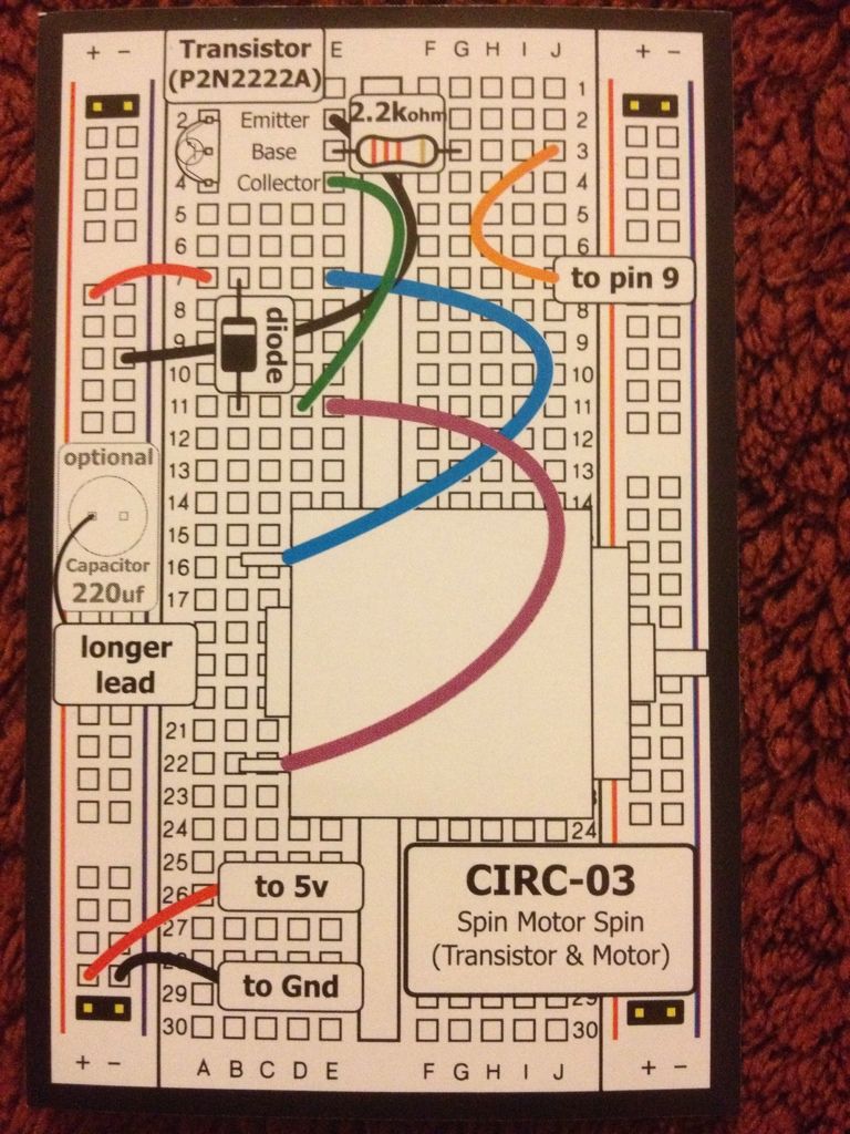

40  Using Arduino / General Electronics / Re: Twisted Transistor on: January 16, 2013, 11:38:13 pm
ok...  I think a lightbulb just went off in my head about how a transistor works...  So, the current from the base has to flow through the transistor as well, and thus needs a path "home" (to GND) just like the external source.  As the "switch" current from the base moves through, it opens the door for the external current to move from the collector to the emitter, so to speak?
I think I get it now?
Thanks for your reply.. it was an "AHA!" moment for me
41  Using Arduino / General Electronics / Re: Twisted Transistor on: January 16, 2013, 11:31:14 pm
So should I run a jumper from the arduino GND to the external source's GND?
42  Using Arduino / General Electronics / Twisted Transistor on: January 16, 2013, 11:20:19 pm
Hello again everyone, I have returned with another head-scratcher.
I am trying to use my PN2222A transistor as a switch so a small liquid pump can run off an external (not from the Arduino) power source.  My pump runs like a champ when hooked directly to it's external (6V 300mA) power supply, yet the transistor switch circuit will not pass any juice through when triggered.  Sounds like a messed up circuit you say?  That's what I thought... but when I disconnect the external supply and instead connect the 5V and GND from the Arduino to the circuit the transistor passes the signal right along no problem...  So the circuit is working correctly when power from the arduino is used, but not when my external source is used.
I checked the data sheet for the PN2222A, and 6V 300mA is well within it's operating range.  I also noticed that the little wiring diagram I was using had emitter and collector mixed up, so I fixed that in the circuit.  I have also swapped transistors just in case the first one was acting funny... no dice.
Why will my transistor and circuit pass the Arduino's power through, but not my external source?
(picture of my little wiring diagram included, as well as the very simple test sketch I have been using to try to debug this problem)
In the picture below, the leads I am connecting to my external source are the ones labeled "to 5V" and "to GND", and I am using the capacitor as well.

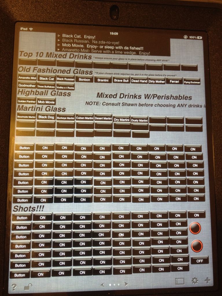

As for the app, it's called "Ardumote" and it is available on the app store.  The website is broken (links don't work) but I have the URL to the tutorial that explains how to set it up, and I also have an example sketch file if you are interested.  Despite the website for the app being complete garbage- the app is actually fantastic and the developer is VERY responsive to email.  I have emailed him twice with questions/issues and both times he emailed me back with answers/sketch files within the hour!
