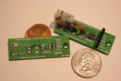

Temperature measurement...
Using thermocouples is a very standard way of measuring temperatures.  They also measure a much wider range of temps than most silicon based sensors.  This chip can measure 0 to 1024 deg C with a K-Type Thermocouple attached.
Common uses could be oven control, temp sensing, fluid temperature, etc.  I have one of the quad boards with 4 thermocouples hooked up to my grill to see my grill temp and I use a few probes to check meat temperature as well.

14  Forum 2005-2010 (read only) / Development / MAX6675 Interface Boards on: July 19, 2009, 08:19:08 pm
Hey all, just wanted to let you know that I put together some MAX6675 Interface boards.  The have the MAX6675 chip broken out, and a Thermocouple connector on the board for a simple interface.  Anyone who has tried to interface a thermocouple directly before, know it can be a pain in the ass.
More info is here http://ryanjmclaughlin.com/blog/arduino/thermocouple-interface-board/ and they are for purchase.  There are single and quad versions, although the quad version needs a better PCB layout, but this one still works.
