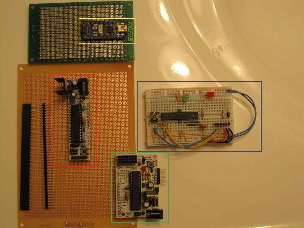

15  Forum 2005-2010 (read only) / Development / Re: Made my protoype with Arduino. How do I make more? on: May 05, 2009, 06:46:34 pm
mdowning, I think the main function of his design is based around using the USB port as a serial port to the computer, so I think he needs a breakout board for every one of them. I may be wrong.
EDIT:
I took this picture of some of the crap I have to give you ideas:
Yellow = Cost Prohibitive, yet beautiful Arduino Nano solution
Red = DC Boarduino, mounts directly into breadboards and protoboards. (so does the nano, obviously)
Green = BBB, use male and female headers or solder directly to protoboard with male headers.
Blue = Custom breadboarded Arduino. Note the diode and resistor near the FTDI header don't do anything, they were going to get lost on my workspace so I put them there.
