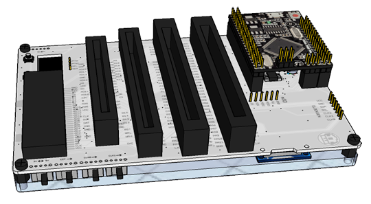

I notice that this redesign has five cartridge ports now, is support for another system being added? If it was mentioned before in the thread I must have missed it. I recall there were people contributing to TG16 support via an adapter, I admit I am not too familiar with the TG16 but that doesn't look like a TG16 card port.
sanni
I don't know exactly why this fixed it but I updated the code on github anyway. :)
The added slot on the design idea I posted is a NES slot but ofc there is no code written for it.
I worked on the design idea a little more, now it has two build options: with or without a backplate.
First build option that should be cheaper.
Second build option with the modules mounted on the underside and thus requiring a backplate.
And the backside of the second build option.
Also by using those longer male pin headers to connect the Mega 2560 Pro you can make an expansion port where you can plug in daughter boards like this one that breaks-out all the pins to two 40pin IDE connectors for prototyping.

Oh wow, I'm surprised you added an NES slot to the cart reader sanni.
Just wondering if you're working on code for it?  I think I remember seeing another device which can backup/restore NES saves, although I believe it's in the beta stage (as tempting as it is to buy this device, I think I'm gonna stick with the Arduino).  I'm looking forward to hearing more news about the new NES slot in the future.
sanni
Well, I would love to order the new PCB but it's $50 or more just to see if I made any mistakes designing it so I'm probably not going to place the order since there are better alternatives to read NES carts with the new infinitneslives dumper.
The goal of the new PCB design was to make building the Cart Reader cheaper but since a 150x100mm PCB is so much more expensive than a 100x100mm PCB that didn't really happen.
Maybe when PCBs get cheaper in the future I'll build it just for fun.

In terms of the pcb redesign, would doing an nes adapter be feasible as an alternative? The other item that might be attractive to people is a gamegear adapter.

My advice, as you mentioned yourself, is to try and keep the PCB to 10x10cm, unless some other PCB fab has a better deal than JLPCB.
Now, I've put the dimensions of your new board (15x10cm) into PCB shopper and JLPCB is still the cheapest at 20$ for 5, https://pcbshopper.com/
I do want to build one, but I'd like to know if and when you're going to update the current design to the new one?
Should I just wait for the new board or go ahead and buy the current version ?
sanni
I'm not planning to update the PCB on github any time soon so you can go ahead and build the current version.
