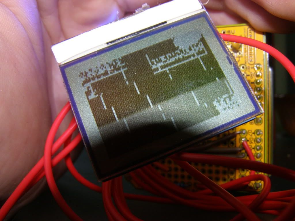

hey there i seen a video from a few years back about pulling a bitmap from a 24lc256 eeprom to a 3310 lcd ,& im trying todo the same, i have my 24lc256 hooked up and i can write bytes and pages "i am alittle new to this" but when i try to put my image on the eeprom im not sure how to go about it. i tryed just putting 16 bytes of the image and try reading it back with this
Code: [Select]
"byte b = i2c_eeprom_read_byte(eeprom1, addr);
while (b!=0) {
lcd.drawBitmap(b, 84, 38);
addr++; //increase address
but it complanes about converting a byte into a char* :s
i not great with c codeing so any help would be great :)
thanks for reading

rotceh_dnih
ar true soz guys the lib im useing is called PCD8544 so not much help there lol i'll post the bitmap function
full code

Okay... so you're using the library created by Carlos Rodrigues.
The issue you're facing is coming because the draw bitmap function is looking for an unsigned char array containing the bitmap. What you're doing in your code is reading & sending single bytes. So what you want to do is read the full bitmap into an array and then pass the array to the draw bitmap function. Since this is a 3310 LCD, memory shouldn't be a memory probelm since 84*38 bitmap with 1 bit per pixel is 84*38/8=399 bytes.
You can try something along these lines of logic...
Code: [Select]
unsigned char bitmap_array[399];
for(int j = 0; j < 399; j++)
bitmap_array[j]=i2c_eeprom_read_byte(eeprom1,addr);
addr++;
lcd.drawBitmap(bitmap_array, 84,38);
Ardgrafix6100 - A fast, full-featured Arduino graphics driver for Nokia 6100 LCDs http://code.google.com/p/ardgrafix6100/
rotceh_dnih
#5
Apr 25, 2012, 10:11 am Last Edit: Apr 25, 2012, 10:27 am by rotceh_dnih Reason: 1
:) thanks man thats what im looking for i think .
one question ithis line here
Code: [Select]
going to read from address 0 through to address 399?
and as im writing this i just tested it and i think it worked :) but what do you think would be the best way to write the whole image to the eeprom as atm im only writing 16 bytes of it and i think wire can only handle 32 and my eeprom is 64 per page :s its all rather confuseing for me atm lol but i'll get there.
so i guess my question how to write a 488 byte array to my eeprom ? im guessing i could then store about 65 images to one eeprom :)
thank you very much for your help so far kind sir!

update
Video of how the image from eeprom looks
http://www.youtube.com/watch?v=ufpCZ6smzXw&feature=youtu.be
i tried to write the whole image but it failed so theres the 16 bytes as the first image the other two come from flash
heres the code as it is now

tried to wirite byte instedd of page but its not looking right "will post pics tommoro"
this time i tried the whole 488 or 489 byte that are in the bitmap but im to neeb to know what im doing  :smiley-red:

and a pic of what it looks like reading from eeprom
it looks like its shifted a small amount of the data over and over again :s

2 suggestions -
1. Firstly, your bitmap_array "me" is 504 bytes = 84 px * 48 px /8 pixels per byte. All your logic in the boot() function is running at 84*38 and BTW - 84*38/8 is NOT even equal to 489 bytes which is the array you are reading in. You need to go through ur program carefully & clean up the logic consistency.
2. If the above doesn't sort out your issue - simplify the debugging  issue into a sketch that does only reading & writing of a long string to & from the eeprom & see if that works properly. You can output the read with serial & read it on your comp & see how the reading & writing is behaving. Once you've cleaned up the logic of writing & reading  a long string from eeprom, you've got a debugged approach to plug  back in here.

:) thanks man i've found a issue i made a simple read wirght code and just sent the first 16 again for testing and found its gets converted somehow not sure whats going on there
heres the output

rotceh_dnih
Solved :)
all it needed was a delay of 20ms after each write ofcourse i feel silly now after reading that in the datasheet at least twice.
working code for anyone who comes across this
Code: [Select]
* 3310 lcd - Interface for arduno .
* Copyright (c) 2012 rotceh_dnih <rotceh_dnih@hotmail.com>
* Permission is hereby granted, free of charge, to any person obtaining a copy
* of this software and associated documentation files (the "Software"), to deal
* in the Software without restriction, including without limitation the rights
* to use, copy, modify, merge, publish, distribute, sublicense, and/or sell
* copies of the Software, and to permit persons to whom the Software is
* furnished to do so, subject to the following conditions:
* The above copyright notice and this permission notice shall be included in
* all copies or substantial portions of the Software.
* THE SOFTWARE IS PROVIDED "AS IS", WITHOUT WARRANTY OF ANY KIND, EXPRESS OR
* IMPLIED, INCLUDING BUT NOT LIMITED TO THE WARRANTIES OF MERCHANTABILITY,
* FITNESS FOR A PARTICULAR PURPOSE AND NONINFRINGEMENT. IN NO EVENT SHALL THE
* AUTHORS OR COPYRIGHT HOLDERS BE LIABLE FOR ANY CLAIM, DAMAGES OR OTHER
* LIABILITY, WHETHER IN AN ACTION OF CONTRACT, TORT OR OTHERWISE, ARISING FROM,
* OUT OF OR IN CONNECTION WITH THE SOFTWARE OR THE USE OR OTHER DEALINGS IN
* THE SOFTWARE.
#include <PCD8544.h>
#include <string.h>         //Used for string manipulations
#define eeprom1 0x50
#define STRLEN 16
static const byte me[] = {
0xC2, 0x41, 0x00, 0x00, 0x00, 0x00, 0x00, 0x00, 0x00, 0x00, 0x00, 0x00, 0x00, 0x00, 0x00, 0x80,
0x80, 0xC0, 0xC0, 0xF0, 0xF8, 0x38, 0x3E, 0x1A, 0x1F, 0x5F, 0x6F, 0xFF, 0xFF, 0x7F, 0x7F, 0x7F,
0xDF, 0xEF, 0x9F, 0x1F, 0x3F, 0xFF, 0x7F, 0xFF, 0xFE, 0xFE, 0x9D, 0x0F, 0x0F, 0x0F, 0x0B, 0x0F,
0x1F, 0x1F, 0x3F, 0x3F, 0xFF, 0xFF, 0xFF, 0xFF, 0xFF, 0xFE, 0xFC, 0xFC, 0xF8, 0xF0, 0xE0, 0xC0,
0x00, 0x00, 0x00, 0x00, 0x00, 0x00, 0x00, 0x00, 0x00, 0x00, 0x00, 0x00, 0x00, 0x00, 0x00, 0x01,
0x00, 0x00, 0x00, 0x00, 0x00, 0x00, 0x00, 0x00, 0x00, 0x00, 0x00, 0x00, 0x00, 0x00, 0x00, 0x20,
0x20, 0xF0, 0xFE, 0xFD, 0xFE, 0xFF, 0xFF, 0xF5, 0x1F, 0x08, 0x48, 0x08, 0x08, 0x28, 0x20, 0x80,
0xE0, 0x01, 0x00, 0x00, 0x00, 0x00, 0x00, 0x03, 0x05, 0x67, 0x0E, 0x26, 0x20, 0x28, 0x28, 0x08,
0x08, 0x0C, 0x1C, 0x1A, 0x07, 0x04, 0x00, 0x00, 0x01, 0x00, 0x01, 0xC7, 0xFB, 0xFF, 0x7F, 0x7F,
0x7F, 0xFF, 0xFF, 0x7F, 0xFF, 0xFC, 0xFC, 0xF8, 0xA0, 0x80, 0x20, 0x00, 0x00, 0x00, 0x00, 0x00,
0x00, 0x00, 0x00, 0x00, 0x00, 0x00, 0x00, 0x00, 0x00, 0x00, 0x00, 0x00, 0x00, 0x00, 0x00, 0x00,
0x00, 0x00, 0x00, 0x01, 0x01, 0x1B, 0x1F, 0x1F, 0x1F, 0x1F, 0x3F, 0x3F, 0xFC, 0xE0, 0xC0, 0x00,
0x00, 0x00, 0x00, 0x83, 0xC0, 0x80, 0x80, 0x80, 0x84, 0x84, 0x88, 0x88, 0x80, 0x80, 0x00, 0x00,
0x00, 0x00, 0x00, 0x00, 0x00, 0x00, 0x00, 0x00, 0x10, 0x08, 0x0C, 0x0C, 0xC4, 0x04, 0x01, 0x00,
0x80, 0xE0, 0xE0, 0xF0, 0xD0, 0xF8, 0x3F, 0x1E, 0x1F, 0x1F, 0x1F, 0x1B, 0x17, 0x05, 0x00, 0x00,
0x00, 0x00, 0x00, 0x00, 0x00, 0x00, 0x00, 0x00, 0x00, 0x00, 0x00, 0x00, 0x81, 0x00, 0x00, 0x00,
0x00, 0x00, 0x07, 0x0F, 0x1E, 0x3C, 0xDC, 0xF7, 0x83, 0x81, 0x01, 0x01, 0x01, 0x01, 0x01, 0x01,
0x01, 0x80, 0x80, 0xC0, 0x40, 0x40, 0x60, 0x20, 0x10, 0x10, 0x08, 0x0C, 0x04, 0x06, 0x03, 0x03,
0x01, 0x80, 0xC0, 0xF8, 0xFF, 0x7F, 0x3F, 0x3F, 0x13, 0x11, 0x10, 0x00, 0x00, 0x00, 0x30, 0x30,
0x30, 0x38, 0x38, 0x38, 0x3C, 0x3C, 0x3C, 0x3C, 0x3E, 0x3E, 0x3E, 0x3C, 0x7C, 0x7C, 0xFC, 0xF8,
0x00, 0x00, 0x00, 0x00, 0x00, 0x00, 0x80, 0x00, 0x00, 0x80, 0x00, 0x01, 0x03, 0x03, 0x07, 0x87,
0xCD, 0x2F, 0x3B, 0x34, 0x08, 0x18, 0x18, 0x1C, 0x1E, 0x0C, 0x08, 0x00, 0x40, 0x20, 0x20, 0x10,
0x08, 0x0C, 0x86, 0x02, 0x01, 0x01, 0x00, 0x00, 0x00, 0x00, 0x00, 0x00, 0x00, 0x00, 0x00, 0x00,
0x00, 0x00, 0x01, 0x03, 0xC4, 0x84, 0x84, 0x04, 0x04, 0x04, 0x04, 0x04, 0x04, 0x04, 0x04, 0x00,
0x00, 0x00, 0x88, 0xE8, 0xE8, 0xF8, 0xF8, 0x78, 0xFF, 0x1F, 0x1F, 0x0F, 0x03, 0x01, 0x00, 0x00,
0x00, 0x5C, 0x84, 0x83, 0xE0, 0x50, 0x70, 0xF0, 0xF0, 0xCC, 0x04, 0x02, 0x02, 0x01, 0x00, 0x00,
0x00, 0x04, 0x00, 0x02, 0x00, 0x00, 0x00, 0x00, 0x00, 0x00, 0x00, 0x00, 0x00, 0x00, 0x00, 0x00,
0x00, 0x20, 0xF0, 0xF0, 0xFC, 0xF8, 0xE4, 0x24, 0x0C, 0x06, 0x01, 0x01, 0x00, 0x00, 0x00, 0x00,
0x00, 0x80, 0x80, 0x40, 0xE0, 0xF0, 0xF8, 0xFC,
char buffer[STRLEN];
int  bufferIndex = 0;
static const byte LCD_WIDTH = 84;
static const byte LCD_HEIGHT = 48;
int scrollPosition = -13;
// A custom glyph (a smiley)...
static const byte glyph[] = { B00010000, B00110100, B00110000, B00110100, B00010000 };
static PCD8544 lcd;
  int me_bitmap_start_address = 0;     //change this to wherever you want to store your bitmap on eeprom & keep track
int me_bitmap_length = 504;            //so that multiple bitmaps don't overlap
  // PCD8544-compatible displays may have a different resolution...
  lcd.begin(84, 48);
  Wire.begin();
for(int j=0; j < me_bitmap_length; j++)
    i2c_eeprom_write_byte(eeprom1,(me_bitmap_start_address + j),me[j]);
    delay(20);
  //i2c_eeprom_write_page(eeprom1, 0x0040, (byte*)me2, sizeof(me2)); // write to EEPROM
delay(2000); //add a small delay
  boot();
  // Add the smiley to position "0" of the ASCII table...
  lcd.createChar(0, glyph);
  // Just to show the program is alive...
  static int counter = 0;
  // Write a piece of text on the first line...
  lcd.setCursor(0, 0);
  lcd.print(" Hello, World!");
  // Write the counter on the second line...
  lcd.setCursor(0, 1);
  lcd.print(counter, DEC);
  lcd.write(' ');
  lcd.write(0);  // write the smiley
  lcd.setCursor(0, 2);
lcd.print("CONSOLE:");
  lcd.setCursor(0, 3);
  if( Serial.available())
    char ch = Serial.read();
    if( ch == '\r')  // is this the terminating carriage return
buffer[ bufferIndex ] = 0; // terminate the string with a 0
    bufferIndex = 0;  // reset the index ready for another string
    //lcd.print("                ");
    lcd.clearLine();
    lcd.print(buffer);
    buffer[ bufferIndex++ ] = ch; // add the character into the buffer
  Scroll("testing shiz",0,4);
  counter++;
void boot()
// int addr=0x0040; //EEPROM Address 0
  int addr=0; //EEPROM Address 0
    delay(20); //add a small delay
//Serial.print((char)b); //print content to serial port
unsigned char bitmap_array[504];
for(int j = 0; j < 504; j++)
addr++;
delay(3000);
lcd.clear();
void Scroll(String message,unsigned char xy,unsigned char yx)
  lcd.setCursor(xy, yx);
  for (int i = scrollPosition; i < scrollPosition + 14; i++)
    if ((i >= message.length()) || (i < 0))
      lcd.print(' ');
      lcd.print(message.charAt(i));
  scrollPosition++;
  if ((scrollPosition >= message.length()) && (scrollPosition > 0))
void i2c_eeprom_write_byte( int deviceaddress, unsigned int eeaddress, byte data ) {
int rdata = data;
Wire.beginTransmission(deviceaddress);
Wire.write((int)(eeaddress >> 8)); // MSB
Wire.write((int)(eeaddress & 0xFF)); // LSB
Wire.write(rdata);
Wire.endTransmission();
void i2c_eeprom_write_page( int deviceaddress, unsigned int eeaddresspage, byte* data, byte length ) {
Wire.write((int)(eeaddresspage >> 8)); // MSB
Wire.write((int)(eeaddresspage & 0xFF)); // LSB
byte c;
for ( c = 0; c < length; c++)
Wire.write(data[c]);
byte i2c_eeprom_read_byte( int deviceaddress, unsigned int eeaddress ) {
byte rdata = 0xFF;
Wire.requestFrom(deviceaddress,1);
if (Wire.available()) rdata = Wire.read();
return rdata;
Cod modder/mapper
srinathdevelopment
ah yup - the write delay.... nothing like a bright new day to surface issues :-)
btw - given this is now working. You can consider splitting your sketch into two  different sketches. A one  time sketch that dumps your bitmaps into the eeprom and another regular sketch that  shows your images in sequence on the lcd .
