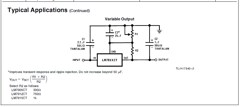

I am building a bench supply.  I have a 36 volt 9 amp supply that I was going to use as a voltage source.  But it doesn't have negative voltage.  I came across this circuit for creating negative voltage:
So that's good.  I can use fixed voltage regulators for many voltages but it would be nice to have an adjustable voltage as well.  So I am looking at this from a data sheet for the  LM79xx:
Here is the link to the data sheet:http://www.hep.upenn.edu/SNO/daq/parts/lm7915.pdf
and this is the part I am having some difficulty with:
Look at the bottom of the page.  There is a set of values for R2 at different voltages.  Using these values I need to find R1 but the numbers I am getting are impossible.  So I suspect I don't grok what Vset is and the only place you will find Vset in the data sheet is right there.  I am using 36 volts for the supply, that is what I thought Vset would be, and I want a negative 15 volts out.  How is this done?  I keep coming up with a negative value for R1 and unless things have changed a lot I don't think you can get a negative resistance potentiometer.

Sorry, joseph_m, but that circuit, as drawn, is dead in the water.

The circuit is a voltage divider where the voltage on R2 is a set voltage (whatever the regulator's fixed output).  So if you're using the -5V supply, Vset is -5V.

Run the number with Vset at -5 volts and that is what you want Vout to be and you get zero for your resistance of R1.  Run the numbers you will see what I mean.
Huh?  Why would you be building a variable output circuit when the fixed regulator already has the voltage you want.  Of course you get 0ohm, because you wouldn't need a divider to -5V out of a -5V supply.
Well that's helpful.  Want to elaborate on that?  It came right out of the data sheet.
The first circuit.  Where did you get it?

The first circuit will (might) output +15V with respect to its GND on the +15V side, OR -15V wrt GND on the -15V side, but there isn't any way that +15V will be 30V above -15V output, which is also necessary for a bipolar supply.

@joseph_m
That first schematic in your post ? What the ?  smiley-eek  Really ?
I agree with Runaway Pancake here.
Let see... you have 36 V and you want to divide by 2 ? Correct ?   Like 36 / 2 = 18 V.
I just have a schematic that do just that. I included in this post.
