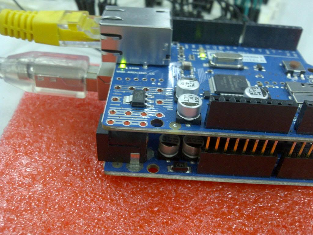

Hello, I found problems when I tried to do experiment with ChatServer and ChatClient using 2 of my PC (Notebook and Netbook)
I am using Arduino UNO and Arduino Ethernet Shield and pile those up.
Then I have connect my Notebook to UNO using RS-232 and my Ethernet shield to Netbook using LAN cable.
Then I compile ChatServer in my Notebook then I upload it, then I compile ChatClient in my Netbook.
Then I open for the serial monitor of Notebook, but it show none.
Is there any wrong with my cable connection? or my steps?
Or I lose some step to do? Telnet?
I get the code of ChatServer (http://arduino.cc/en/Tutorial/ChatServer)and ChatClient (http://arduino.cc/en/Tutorial/ChatClient).
I insert mac address same with my Ethernet Board mac address.
This what I insert in my ChatServer:

Code:
IPAddress ip(192,168,1, 27); // same with my Notebook LAN IP address
Code:
IPAddress ip(192,168,1, 42); // same with my Netbook LAN IP address
Are you saying those are the IP addresses of your notebook and netbook?
They should be the IP address you are giving your Arduino, and must be different (in the last number) to any other device on your network.

Yes, the sketch is not using DHCP, so you need to set the IP address. It should be on the same subnet as your existing machines, so the first three numbers should be the same (192,168,1) and the last number needs to be unique on your network, and preferable outside your router's DHCP scope. I would try
Code:
IPAddress ip(192,168,1, 99);
unless you already have 99 machines on your network.

No. There was no need to change these:
Code:
IPAddress gateway(192,168,1, 1);
IPAddress subnet(255, 255, 0, 0);
Unless you are trying to connect to the APNIC Debogon Project in Australia, you probably need to change:

Do you have two Arduinos? Both the ChatServer and ChatClient have to run on an Arduino/Ethernet shield.

I only have one Arduino UNO and one Arduino Ethernet Shield, I pile those up.
My notebook connect to the UNO using RS 232 then my Arduino Ethernet Shield connect to my Netbook using straight LAN cable.
Quote
How to run both of them? compile it? or upload it?
I have upload the ChatServer to Arduino UNO but I can not upload the ChatClient to Arduino Ethernet Shield since it only connect via LAN cable no RS 232.

You can't run both at the same time. Both of those sketches need an ethernet shield, they aren't designed to run over serial.

What are you actually trying to achieve?
You can upload either of the sketches to the Arduino/Ethernet shield. If you upload one, then the other, the second will overwrite the first.

Quote
What I am trying to achieve is I can chat between this two of my netbook and notebook using ChatServer and ChatClient.
You can't do that with only one Arduino and Ethernet shield.
You can't upload a sketch to the Ethernet shield. The sketch runs on the Arduino that the shield is attached to.
You would need two Arduinos, each with an Ethernet shield.
